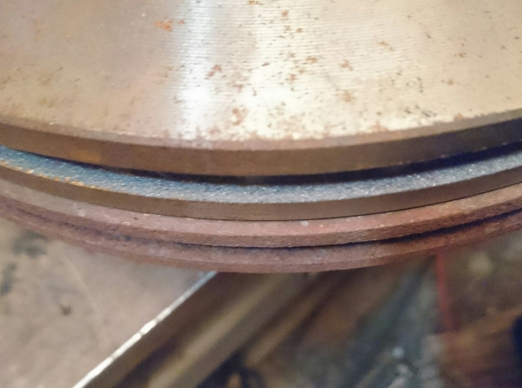

Ordered new rotors over a year ago, and have finally gotten around to changing them.
But the new rotors are a bit smaller than the old ones, so now I'm not sure if they're the right ones.
The same rotors (7008R) at classicindustries are listed for 70-72 B-/E-body.
If they are different for -69, are they still available, or do people just use the (slightly) smaller ones?
If the bearings fit between them, haven't checked...
Edit: guess it could be that the ones already on the car are slightly bigger than the correct ones :p
The old ones are 11.25" while the new ones are 11".
Sounds like they are wrong. Original 69 are about 11.25" and original 70-72 are 10.98" Plus bearing and other difference, I do not think they will work. G
I see 11,19" mentioned some places when i try to google some solid info on this.
But Year One have 11" rotors listed for 69 with 4-piston calipers.
The old rotors on my car are larger than, or going outside the pads, wich to me would suggest they are slightly bigger than the correct ones.
Guess I'll just have to see if the new ones I have will fit.

The -70 rotors I have fits the spindle but looks like they have different offset from the ones already on the car. Haven't checked where the difference is, it might be that the "braking surface" is further out on 70 rotors and that 70 calipers is bolt on.
