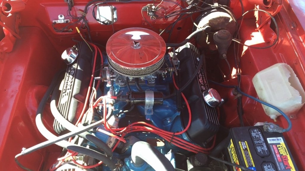

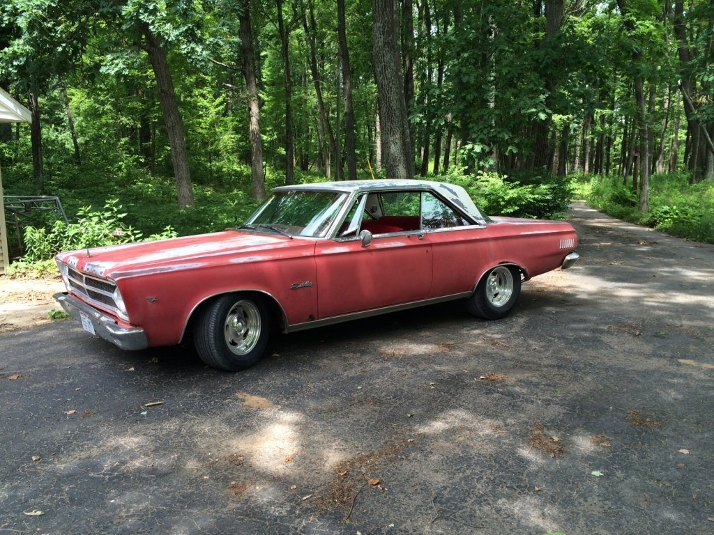

I'm new to the site and am looking for help with the first project I need to do. The car is in need of a complete brake job.
I plan on doing the front brake swap from drums to discs (based on the Mopar Online Disc-O-Tech article) and figure as long as I've got the front end apart, I might as well give the suspension a once over. I'm looking for any suggestions on what I should do for the front end.
Another issue is the rear-end. This originally had a 318 with a non Sure-grip rear end. With the 440, I need to change that out too. How difficult is it to swap in a Sure-Grip and where can I find one?
So any help is appreciated.
