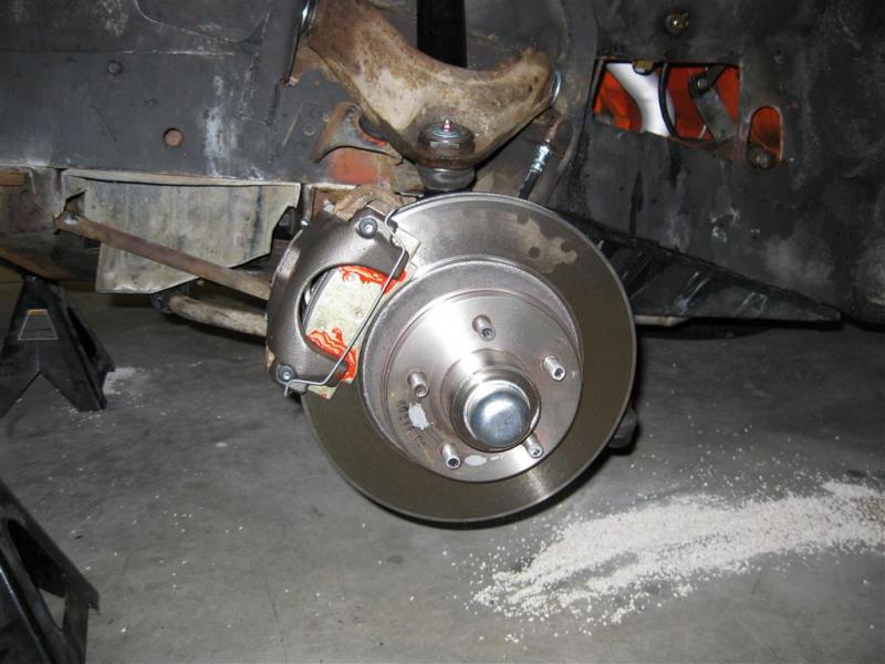

I would not say they are impossible to find. The last two sets I needed I got for about $100 a pair with just a want ad here. I just did my Road Runner a couple months ago. EDIT: I see your in England, that does make it harder.
Thanks for the pic. I'm wondering if it would be cheaper to het a kit with the slider type calipers and brackets and be done. Think that would work? Doctor Diff has a view options that run at a good price if I convert calipers.
The slider style work just fine and calipers are cheap. I would talk to Dr Diff as to what brake hoses to use so you don't have to pay shipping twice.
