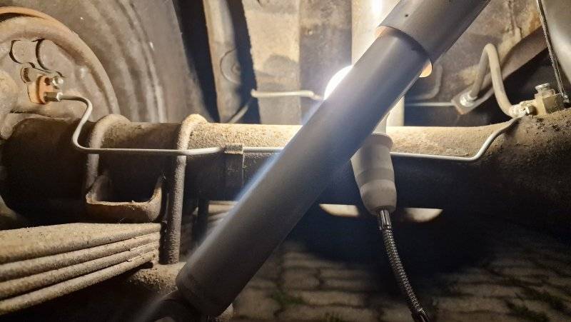

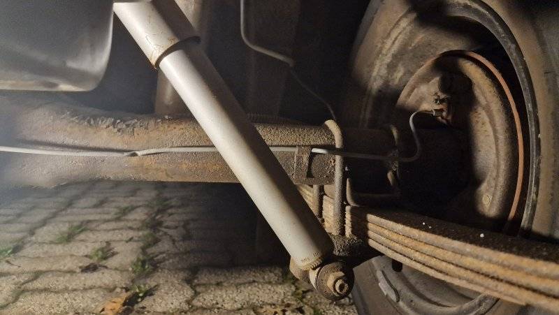

Hello,

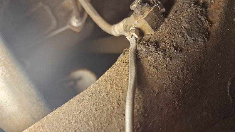

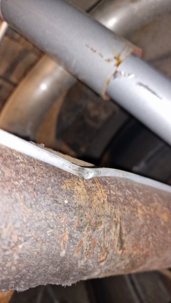

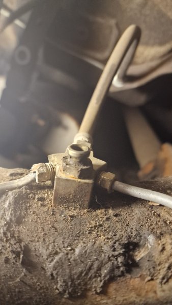

I need help with the brakes. When importing a car in a container, I assume that the car was secured with a chain over the differential and brake hoses, now these hoses are compressed. Now I don't have rear brakes on the car. I tried unscrewing it at the brake cylinder and it goes without a problem, but at the axle break line tee block, things get complicated. I can't unscrew the screws, any suggestions? My 10 wrench doesn't fit, what size is this nut? The nut is damaged by the chain, which tool should I use?
Thanks in advance for your help.
Cut the line at the nut and drive a 6 point socket on it. 2 minute job.
Should be 3/8" but use vice grips if you have to.
You can buy prebent new lines for the rear axle.
You may need to remove the block from the housing to get a good grip on the damaged nut with a 3/8" wrench or vise grips. File some on th damaged nut somthe wrench will go on. Then hold the block with pliers To loosen the nut.
The 4" 4LW Vice Grips designed for nuts work great on brake lines (note: pic is 7").
Also if you buy pre-bent brake lines, keep in mind that there are a lot of different lengths, and the tee wasn't always in the same location.
Thanks for the tips and solutions. I'll make the brake pipes myself, that's not difficult. But first as a lot of you suggested I need to buy the correct tools. I'll try and cut the 9 wrench so it will fit for now. Since I have to wait a long time to get something.

If I didn't have fuel problems I wouldn't even know about it. At first I saw only one pipe twisted and I thought ok everything happens but yesterday I saw the whole story..
