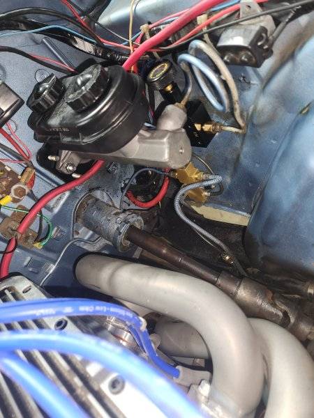

Is your master cylinder bore size correct for the front calipers you are using? Also correct size master cylinder reservoir correct. What you show in your pixs doesn't look like a Mopar unit but one supplied with a conversation kit. Bore size directly affects the applied pressure to the calipers (and rear wheel cylinders) and how much squeeze on the calipers and therefore braking or clamping pressure on the rotor. Is the front rear proportioning valve operating correctly? Is the peddle push rod set to correct dimensions. Is the residual pressure valve in the master cylinder ok? Just a few points to ponder.....

Bore for the master is 15/16. That is what Cass from doctor diff said for the best line pressure. The previous new master was one for a 72 charger that had a bore of 1.04in and pedal felt the same. Pedal pushrod has no extra play and I believe utilizes the full stroke, I can measure the stroke to make sure. It is just a distribution block and only a knob style for the rear. I have adjusted the knob and I believe it is working ok. I do not know if this master has a residual check valve.

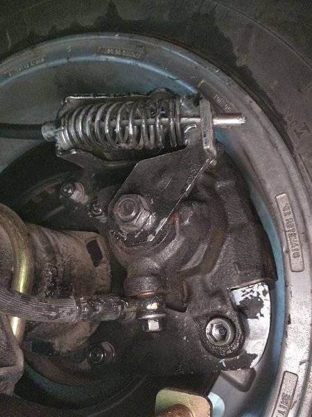

The rear bleeder is behind the arm
All calipers seem to be aligned. The rear brake hoses have a lot of movement. Front brake hoses do not move.
This style rear GM caliper does not self adjust caliper piston travel. Hit the E brake a bunch of times. This will ratchet the caliper piston outward closing up piston to rotor clearance.
