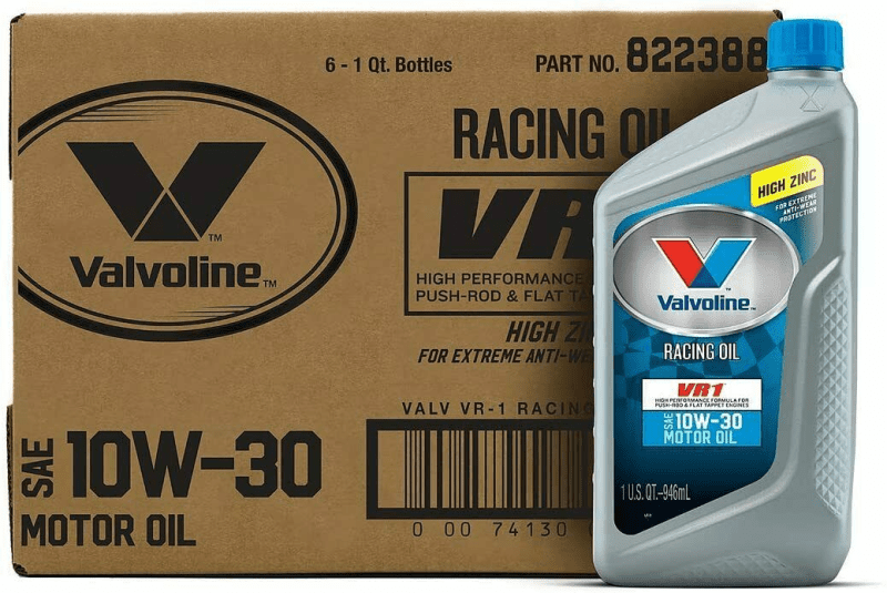

I will be breaking in my 383 all stock refresh soon. I use Valvoline VR1 oil in all my engines. I do the break-in with it, and that's what is run in it. With today's cams, I make my initial start and run for 30 minutes at 2000 rpms. Otherwise nothing special.

I would use the Lucas BIO mentioned above. I run 15w-40 Rotella in everything that has stock valve springs. VR1 if it has heavier springs. All flat tappet of course.

I used the Lucas above without any problems. VR1 after for the life of the engine.

Thanks for the input! Been debating on VR1 or Penngrade. FWIW it seems like VR1 seems to be what most guys use.

However, after break-in I use Valvoline VR1 synthetic for just about everything now, except my newer vehicles where I use Mobil EP or ESP.
I use VR1 in my zero turn mower, golf cart, Charger and so on.... I wouldn't use any additive, I would use VR1 or other oil designed for flat tappet cams without the extra additives.

Best advice: buy a good proper breakin oil, and use good oil with zinc in it after. VR1 is a good choice.
