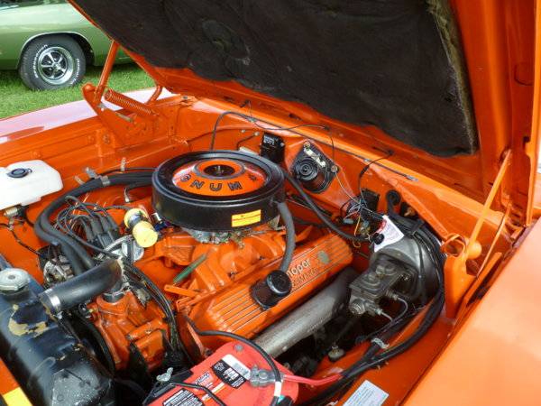

Not sure if I am answering your question, but I have a breather in place of the fill cap on the drivers side and the PCV (with grommet) on the passengers side.
Thanks Ranger, kinda what I am doing.

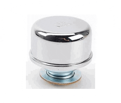

I found a better picture of what I am trying to do.
If you look closely, that breather has the twist cap welded/attached to the bottom of it to fit the MP valve cover. You can see the ears of it below the breather just barely sticking out. My buddy did that to my Runner before I put the stockers back on. He welded a MP twist cap with a hole drilled through the center to the bottom of a breather. Looked and worked sweet when I was using those covers. They also make a twist cap one that'll fit the MP twist oil cap hole with a breather built into it.
http://www.manciniracing.com/mopbotven2.html
Great 91, thanks for the help!
Not a problem. I had to cut and add a thin piece of rubber gasket material on top of the cork that was on there as it had some slop. I have seen others that fit right out the box, so maybe different castings of the MP covers? Either way once I added the rubber to it it sealed and fit awesome.
