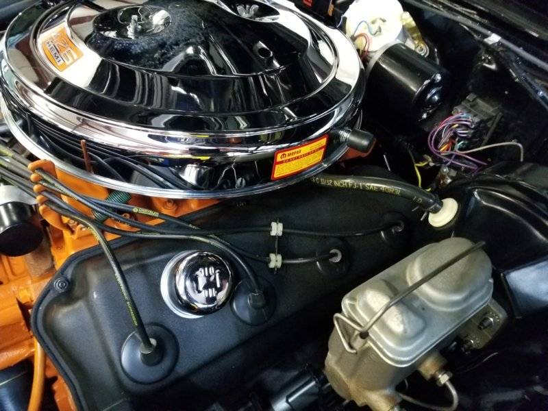

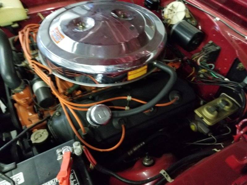

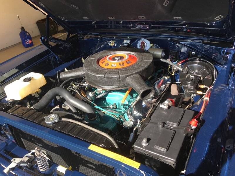

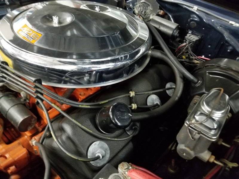

67 Hemi GTX'S, here are the pictures of my four. I thought I would ask here for a start, to see which cap and hose are correct for the breather on a 67 Hemi B body. Chrome cap or black cap? Formed hose or curved hose? All are Belvedere GTX'S.
This one I know is not correct. It has no hose and no place for the hose on the cap.
This one has a black cap and a curved hose.
This one has a chrome cap and formed hose.
This one has a chrome cap and a curved hose.

All input is appreciated. My thoughts were a chrome cap and formed hose. What's yours?
Don’t remember ever seeing a ‘67. The question and pics remind me of 68’s when ‘clean air ‘ emissions started in. On the Bee,formed hose & chrome breather. Sorry, can’t help anymore, Jeff.
