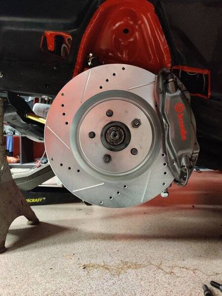

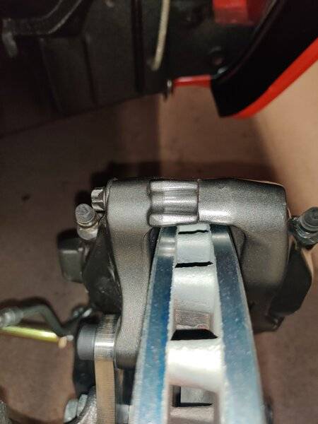

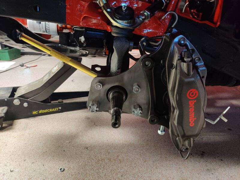

I went the Mustang Brembo route. I made my own brackets but the guy mentioned above makes them and sells them to a fair price. The Chrysler or Dodge brembos could also be fitted but they required more work as I understood. I assume it has to do with the offset. Mine fit perfectly with a 10mm steel plate as adapter to the old drum spindles.

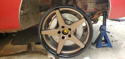

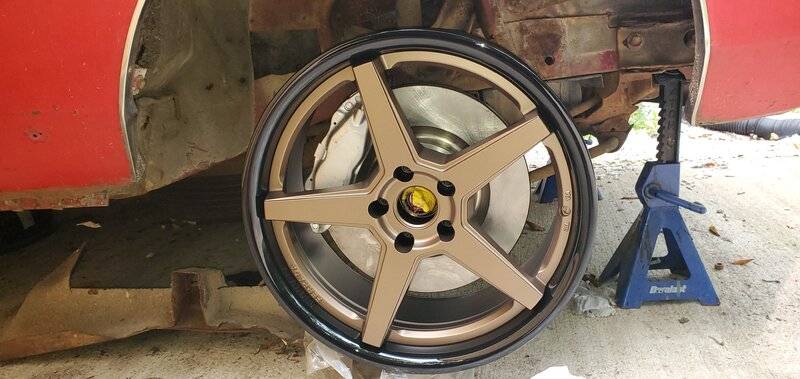

I got the GT500 calipers. Im running 19in rims with the 05-13 mustang brake and rotors. I got the caliper on the wrong side also

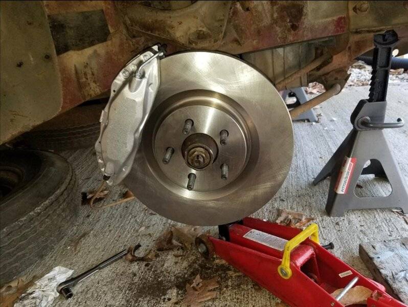

For the Invincible Extreme kit it's whatever years include the 2010 Mustang. The mustang GT front rotors are 13.2", GT500 (brembo) fronts are 14". I bought the brackets and have been running the 13.2" rotors for about 4 years now. I have 18x8 AR Torq Thrust D and the calipers are wide enough that it needs a 1/4" spacer. There is still a fair bit of room between the caliper and the barrel, but I don't know if the brembos would clear. There's a thread on dodgecharger.com with quite a few posts and at least one member over there is running the brembos with this kit.

Thanks, that looks pretty good. What did you use as a hub?
The same, drum hubs and spindles. I made my own brackets at work from 10mm steel. We have a waterjet cutter that made the job easy.
I had to take off some material on the Mustang rotors. The mopar hubs is slightly larger than the hole in the rotors. It wasn't much, maybe 0,5-1mm off.
