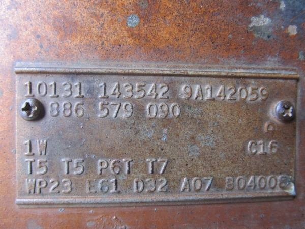

I don't believe I've ever seen A07 coded on a fender tag. Can you post a picture of the tag?
No problem. Happy to help.
Here ya go...
In that location, A07 is not a sales code. It indicates a scheduled production date of October 7th.

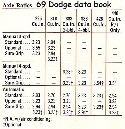

I'll confirm that on the 383 2v b body I have one and YUP it's a 2.76 open gear.... all the best my friends
I found this...the 2.76 would be the standard ratio behind a 383-2bbl automatic
