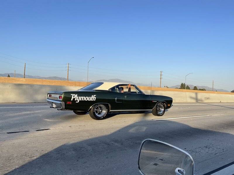

So I bought this 1970 satellite 383 and I really love the car.
