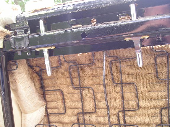

I am not sure if this picture is going to show up or not, but if it does it may help you figure it out.
The yellow/white pieces are the plastic parts that sit on top of the metal seat frames under the seat cover. The headrests posts go through these and the chrome bezel that sits on top of the seat upholstery and the bezels screw into the plastic piece.
that picture helps a lot. where can i get that stuff. I am looking at 68 charger seats that i will re cover for my dart. im wondering if it has that kit inside it. the charger seats have no headrests. I have a set of head rests with the chrome bezels but not anything of the other stuff in that kit

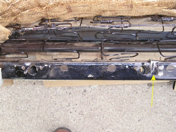

FWIW...here's a disassembly sequence taken of a bench seat out of a 69 Coronet 440. You can see how they come apart. (The chrome bezel obviously goes on top of the fabric. I just took the picture with it setting on the plactic part)
that explains a lot. i think im confident in what i need now to do that job. What is that last piece for (what purpose does it serve). The one in the last picture.........thank you for all the detailed pictures

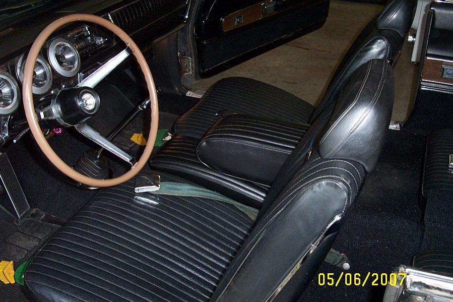

In case anyone cares, the 66 seats in my black Charger had the headrest holes in there already..I just added the headrests.
