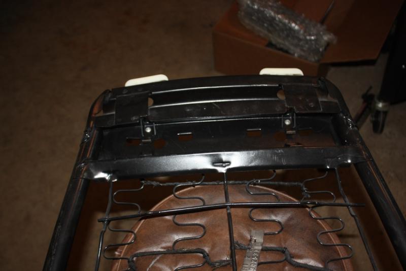

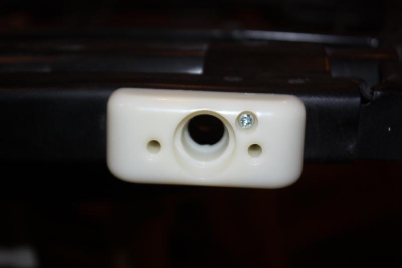

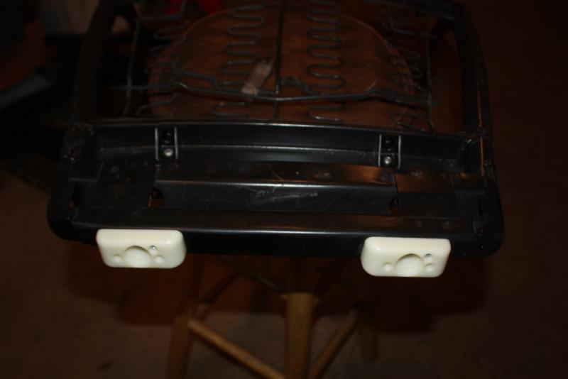

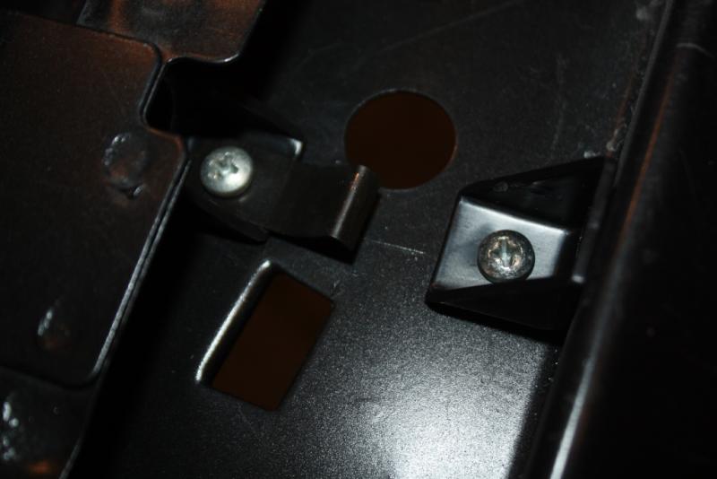

I am looking for a set of original bucket seats for my 69 rr. Mine originally came with headrests. My question is are all the bucket seat frames the same or were they different if they had the headrest option? I can't find any seats with headrests anywhere.
The frames are the same. A hardware kit was added for the head rests. It is available from Mega and others as well.
http://www.megapartsusa.com/proddetail.asp?prod=171-HR810-BUK-KIT
Picture of the hardware installed below.
Hope this helps.
D
Big D hit it. The headrest became mandatory in early 1969 so the 68 and early early 69 seats did not have headrest. Like big D said you can get the kit and add headrest to any Bucket or bench frame.
