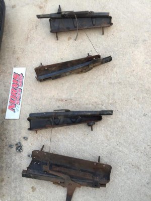

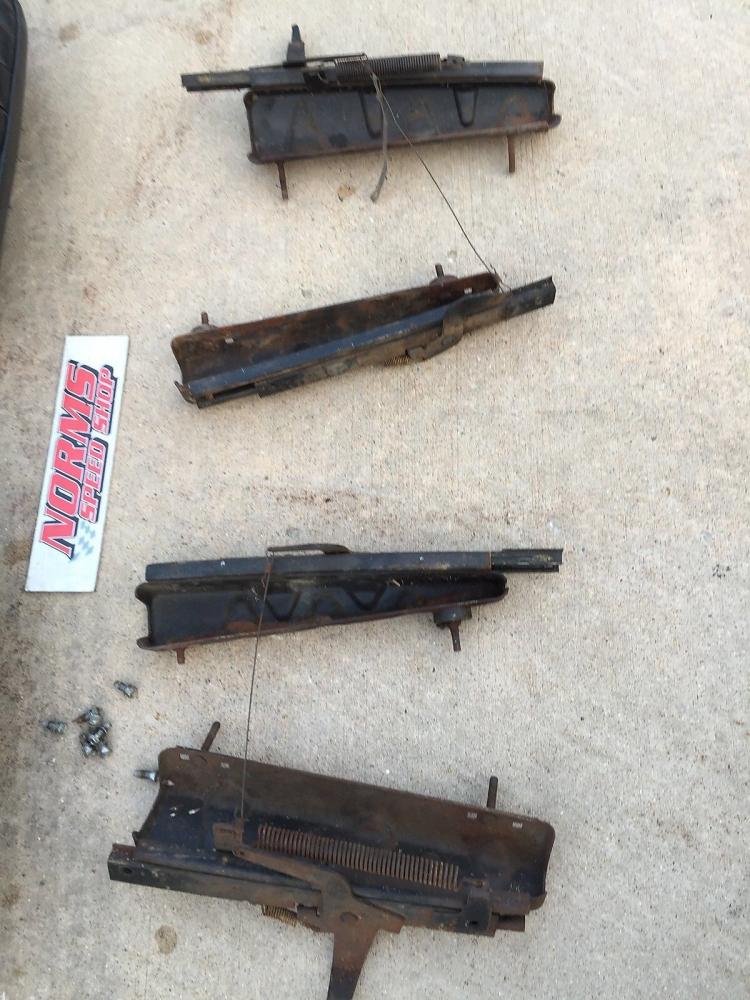

The tracks are a lot different in size. Outside is much thicker than inside but that's the way the seats come from the factory
The floor has been replaced and is brand new.
This pic is just for reference.... Same tracks on my seats
Tracks are right for 70 Bee. Sounds to me more like an aftermarket floor- or reinforce plate problem.
You sure they are the right tracks? Some cars have lower tracks on the door side because there is a raised area there. The floor pan on the inner side is lower so the track is higher.

That sounds about right but my charger seats have those already uneven tracks. I may just have to get longer bolts and use spacers
