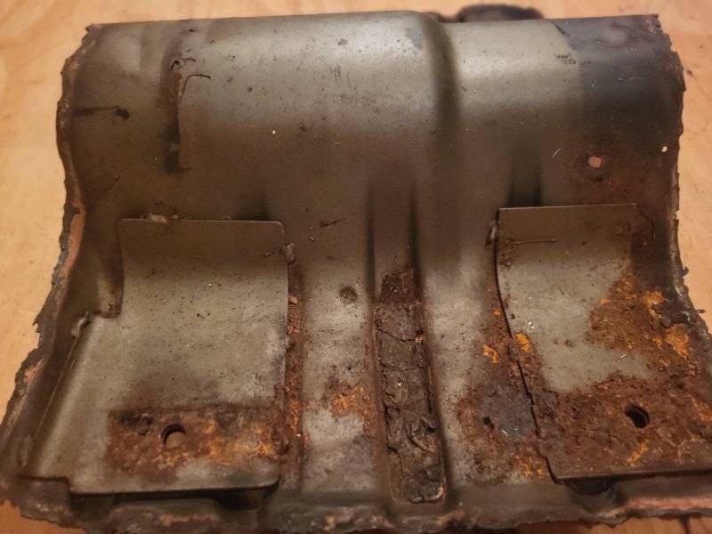

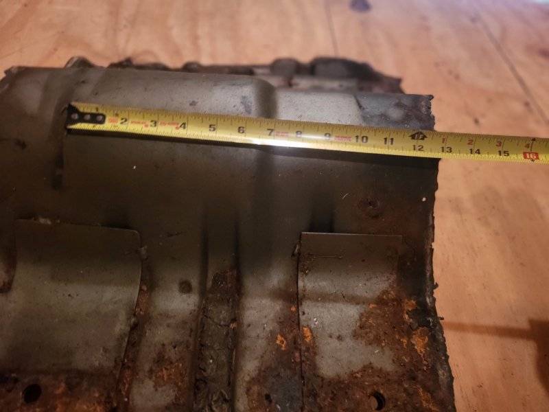

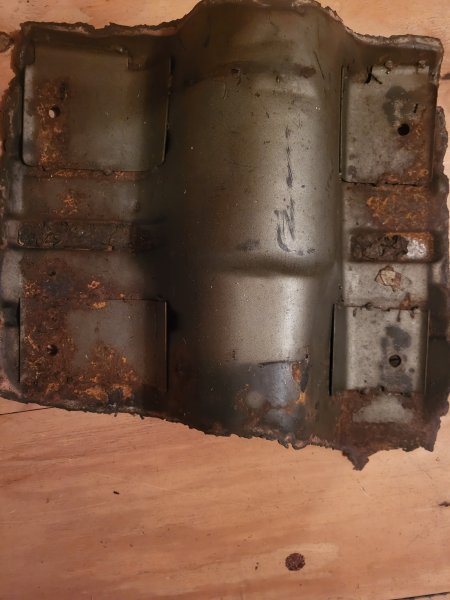

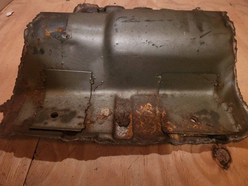

I have the tunnel section out of a 67 Satellite with the buddy seat brackets. If I remember correctly, the piece I cut out extends outboard enough to include the inner bucket seat mounts. I can take a look tomorrow and send some pics & measurements if you want. Otherwise, the suggestions above sound good.
Yes. Any pics with measurements would be great info to have and compare.
Not sure if these will be helpful or not. I didn't remember taking the brackets off the floor. You can see where the weld were broken to remove the brackets. They appear to mostly in line with the seat mounting holes. Let me know if there are any views or measurements that would help.
There are flat spots but no dimples.
That gives some flexibility.
I agree, put the brackets on the buddy, then test fit and mark.
IIRC the front bracket can only go in a small area.
View attachment 1564265View attachment 1564266View attachment 1564268View attachment 1564267
All of the pics are very helpful. I’ll bolt it all together, line it up, and mark it up. Thanks for providing the pics.
