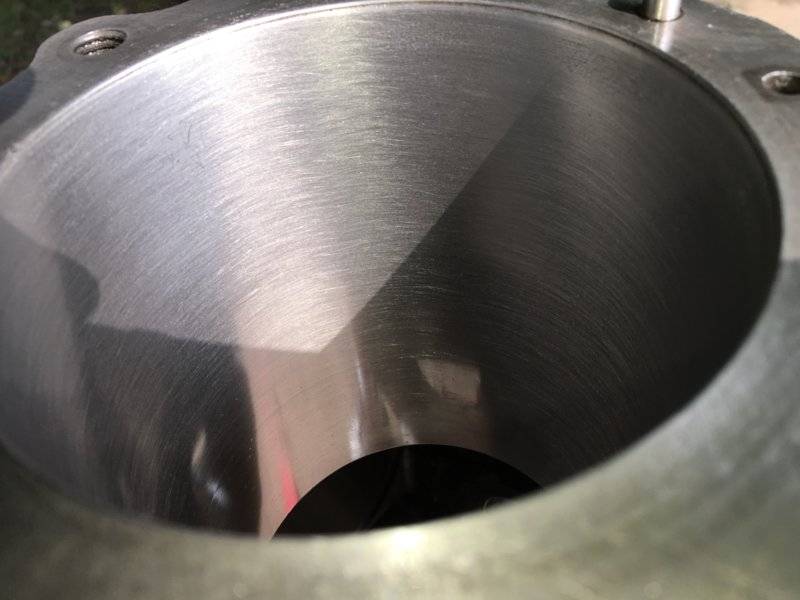

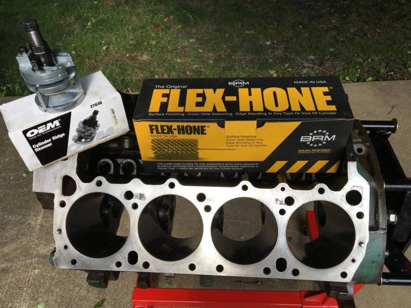

Hello Folks! I'm rebuilding a 9-17-68 383 engine. It was originally installed in a 1969 Charger 383 2Bbl, so it's the advertised 9.2 to 1 compression ratio.
My Plan:

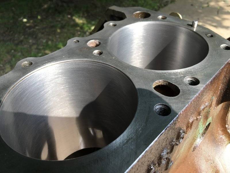

Disassemble, remove ridge, Flex hone, measure x 54 times and pray the bore measurements I get are lower than 4.2515!
I hope to thoroughly clean all pistons, install NOS Mopar rings, new Main and Rod bearings, new oil pump (standard pressure), fuel pump, 2806301 cast 4Bbl intake with Carter AVS, Aluminum Water pump and housing, new Cam and lifters, valve springs, and 1968 HP factory manifolds........... AND LET HER RIP!

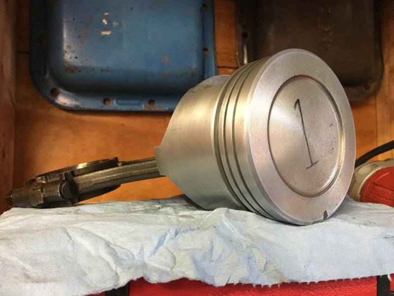

* Pistons 1,5,7,and 6 have a number (casting?) 2863116 inside piston.
*Pistons 2,3,4, and 8 have number 2863115 inside piston.
I read in my 1968 parts book that there were .005" over pistons and standard size. (in addition to .020 and .040 over pistons available.
Do I have some cylinders which were .005" over from the assembly line? The part numbers in my book are 3004524 and 3004525 (.005 O/S).

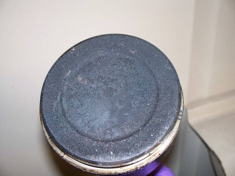

My 69 383 HP pistons have two numbers in them one digit off from the other. Not sure the reason for two numbers? Are you sure you only see the one number in yours?
Also, the HP piston with the flat top actually comes out to around 9.2:1 compression with stock 906 heads and stock block deck height. So your dished pistons will be south of that number. It would be interesting to know the CC's of the dish?
BTW, nice clean job on the pistons. What was your method for getting them cleaned up like that? I'd like to do the same with mine.
Yes, I do have two different numbers.
.005 O/S and standard?
No, I mean each individual piston has two(2) part numbers behind the skirt, not one(1) part number per piston.

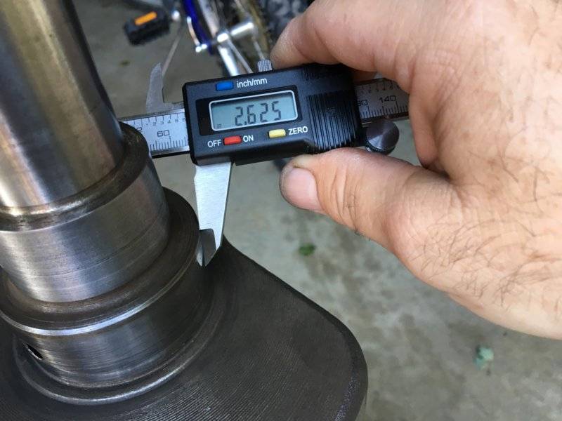

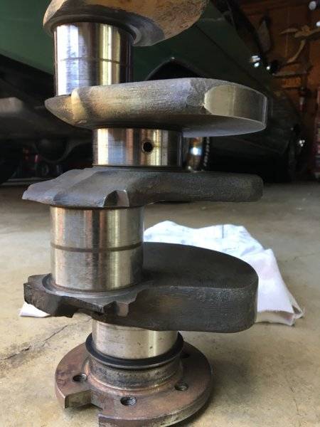

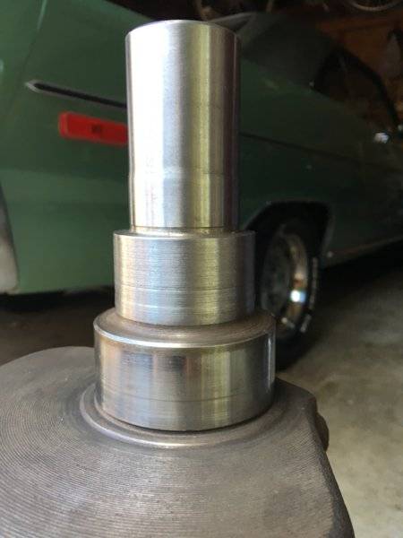

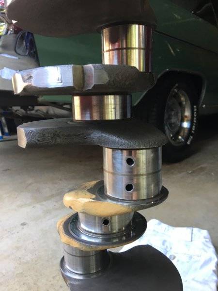

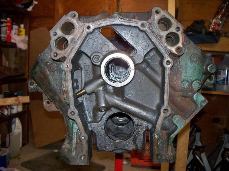

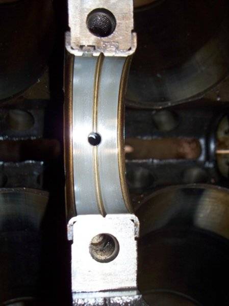

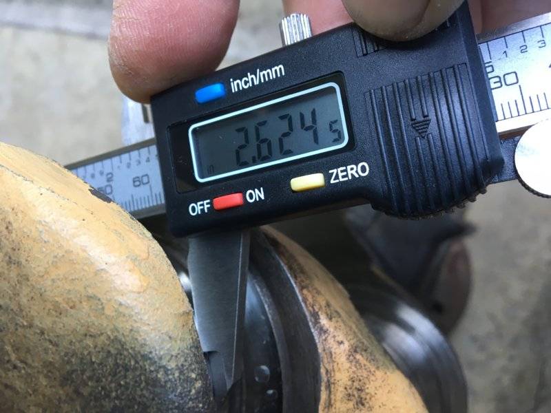

What's going on with the rear main seal surface? Looks pitted....The rear main bearing surface doesn't look great either but that seal surface is sketchy..
Even though I feel like a complete idiot, THANK YOU for clearing up that one! I went out to the garage just now and yes, both numbers are in each piston - one on each skirt.
Thanks man. Not the best method, but it worked ok for me - I soaked each one in large can of WD40 for a few days, Scotch brite pads, oil, old piston ring, and a ton of elbow grease!
The rear seal surface actually looks pretty good, still has factory XXXXXing.
This is the crank prior to polishing/cleaning.

If the bore measurements are way off, I won't be reusing the pistons. It will be bored and new slugs will go it.

The parts don't look bad. How is the end gap on the new piston rings? You can use a new ring to get an idea of any significant taper in the cylinder bores. You just check the gap 1.00" below the deck and then an additional 3.00". And you can check the piston fit with a feeler strip. I just don't want you to get done and find there is too much blowby. I haven't used that Summitt cam. The numbers @.050" look fine.
