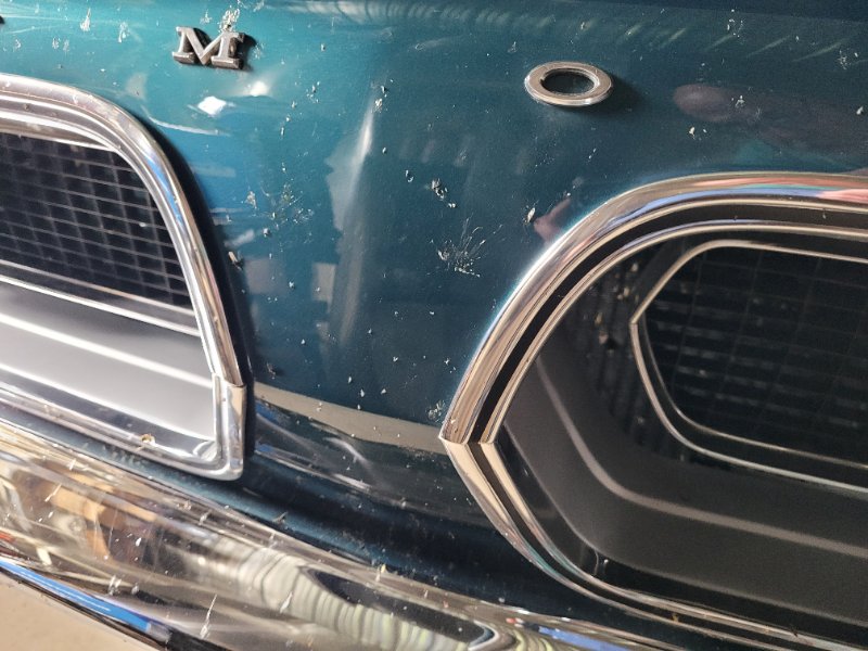

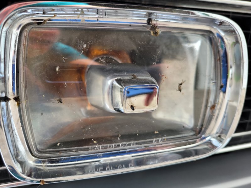

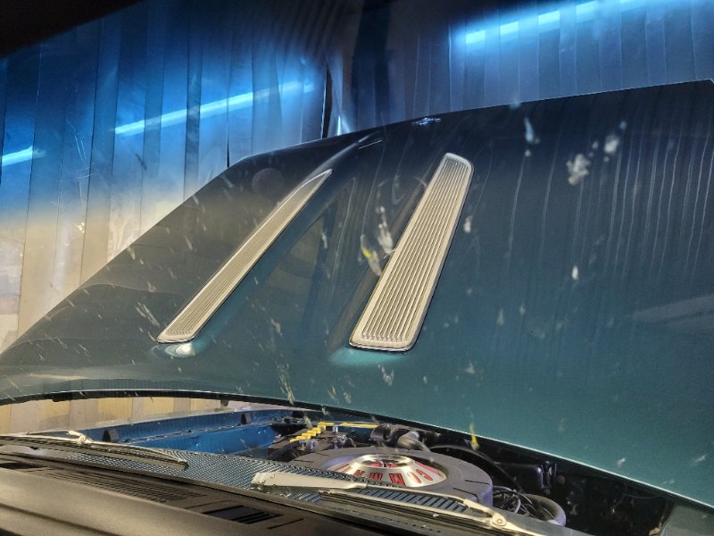

Have you guys found any magic formula that will remove dried on bug splatters that won't damage the paint? I always put the job of cleaning the bumpers, grills, and front ends off until covering up the cars for the winter, and it sucks.
I always try and get them off right away.
Even after a few days I've seen discoloration and paint deformation.
I do recommend ceramic coating (a good one like 3M or chemical guys) bugs come off much easier.
To clean dried bugs I start with a quick detailer and let it sit 5-10 minutes.
I use a cotton cloth with a little tooth to it a microfiber towel just moves stuff around.

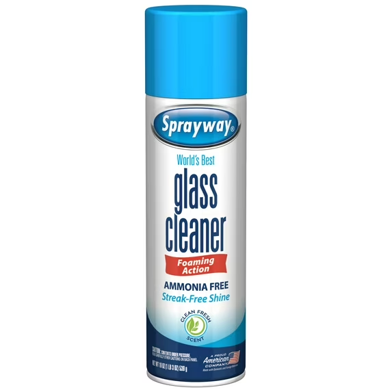

If that doesn't work I use a cheap foaming glass cleaner and do the same thing spray wait a bit and clean something else.
Of course with just wax you've likely lost your wax in that area now.

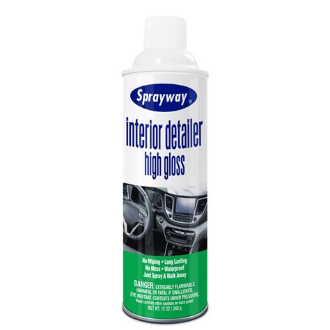

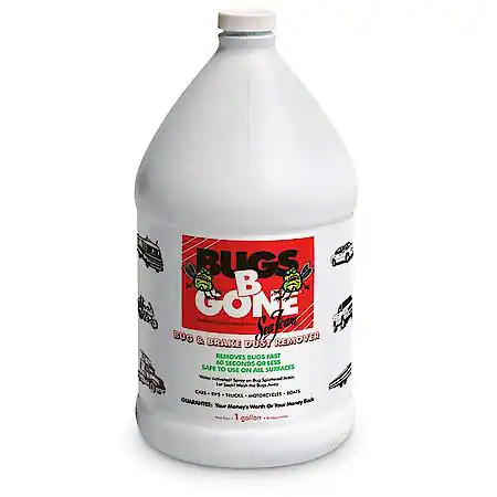

Either A or B does the job.
I bet spraying the front with wd40 or maybe baby oil (or similar) before driving would be a good preventative
It sprays on. It's a foam. Let it soak in and wipe the bugs off. It is a great window cleaner as well. You can find it at Wal Mart and Menards.
Thanks guys. I'll try the Sprayway first since I'll be at a Menards in the next few days.
