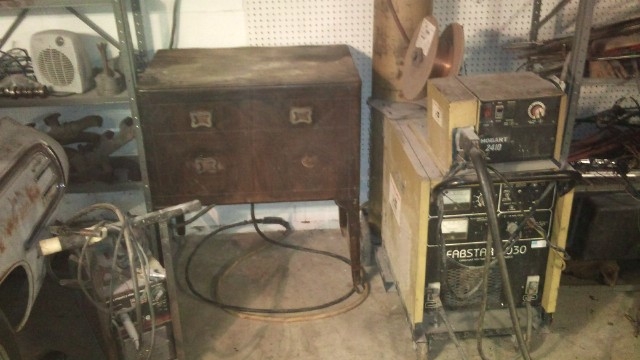

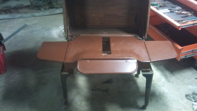

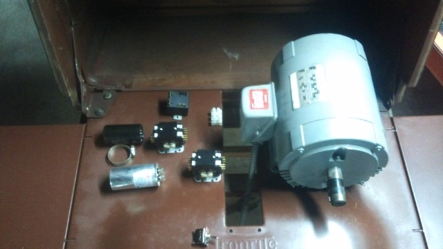

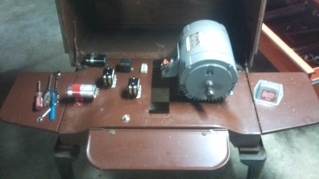

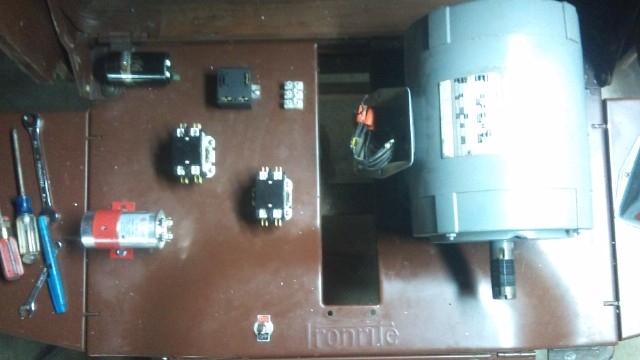

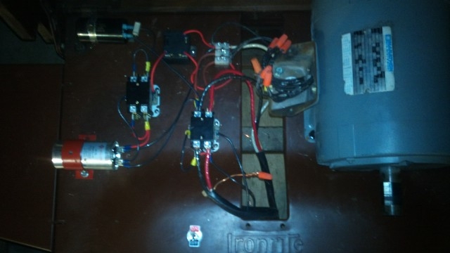

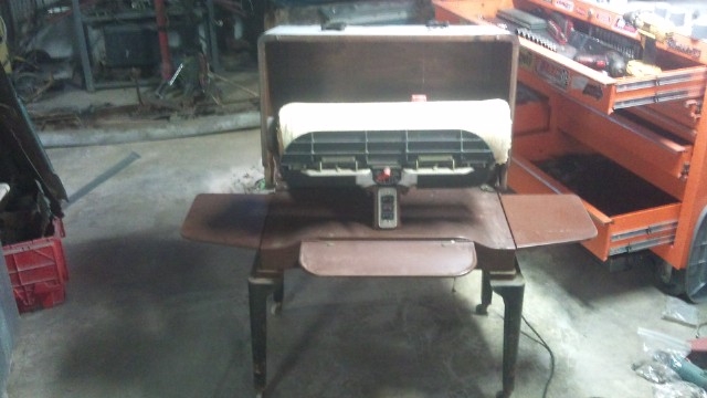

Do you have any equipment that runs on 3 phase electric but your house or place of work is not so equipped? You could buy a rotary phase converter for about $800-$2500 or with some simple electrical know how you can build one alot cheaper. That's what I did. I bought some plans off of Ebay for $3.00 to build a phase converter, and I spent about $125 in parts. It's nothing more than 2 capacitors 3 relays and an idler motor. And you have to find something to encase all of the said components. I have a 3 phase welder that I needed to hook up at my new house where only 2 phases were available. When I moved into the house there was an old Ironrite enclosed iron( old *** iron, they were popular in the 40's and 50's) but it made a perfect cabinet for my phase converter. I put it all together tonight and it works. If anybodys interested I will share the places I got all of the components, and the wiring schematic. It's really pretty neat. I used a coil bracket off of a 383 intake I had to mount the large capacitor on the bottom left. enjoy.

The one I built is an 8 HP unit. The only difference in the HP rating is the amount of capacitors and there rating, and the idler motor rating. To get 30 HP you would need to run about 8 capacitors, 4 start and 4 run capacitors. You hook them up in parallel. A 30 HP unit would cost about $400 or so to build, (I'm guessing) And if your phase converter is rated at 30HP it should at least be able to start a 15 hp motor.
My welder takes 50 amps at max power and doing the math puts it at about 10 HP, I've welded up to 1/4 inch steel and have not put the heat setting past 20 amps, or approximately 4 HP. So an 8 HP converter should be plenty to handle anything I plan on welding.
