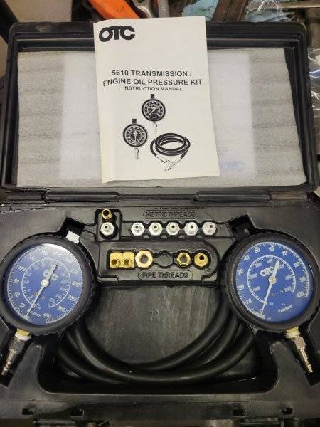

Here's a good pressure test kit if you don't have one..
No manual? What year is the trans
Cooler is fine spaced out from rad, if not better..
Here's a good pressure test kit if you don't have one..View attachment 1866579

Finally got a pressure gauge, so far just checked the accumulator port, in first i get a steady 100psi, if i pull the tv arm back it goes upto 150psi.. not sure where it's supposed to be. Did a search and keep getting different opinions..
