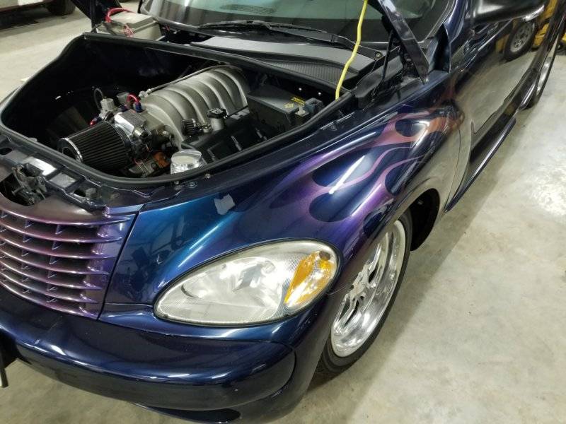

I like to make HP the old fashioned way. No nitrous, no blower or turbo charger. Do it with cam, carburetors or fuel injection and cubic inches. A lighter car helps too. Note the 6.1 bored and stroked to 426 inches, fast fuel injection and monster throttle body. Also no heavy car = 9.5 quarters.
