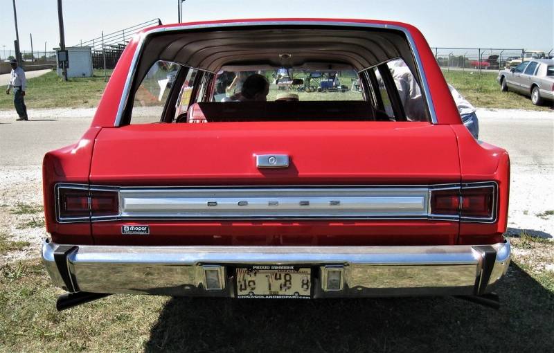

"Running light"?
Not sure my 67 Bell wagon has this.
Pic?
I LOVE "Evil Dead II" but I didn't see a pic of those lights.
I did find one-
Apparently mine does NOT have those.
You are saying the red lenses on the tailgate have lights.
Interesting. I do believe they make dimmer bulbs than 1156.

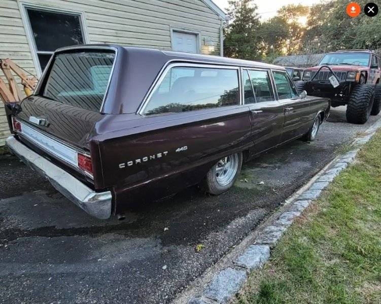

sorry ...its my sons car and his site im linking too.hopefully this shows up.
Nice car.
