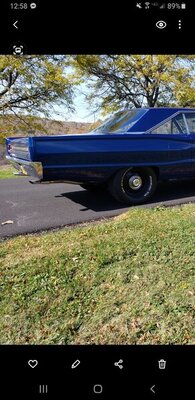

While our car has been in the family for almost 40 years ,it seems no one noticed the rear bumper has been crooked all along .
I noticed it right away and made the mistake of pointing it out to my wife .
Of course ,now it needs to be fixed . Hopefully the picture will show the angle of the bumper to the "cut away " in the body panel .
Am I able to remove the bumper and shim it ?
The bumper support brackets look original and straight

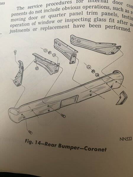

It could be the wrong bumper brackets? Pull the bumper off and see what they did... here's how mine fits.

I don't think they can be swapped side to side without modification... nor can they be upside down without cutting tabs off... pull the bumper and see... my guess is the brackets have been cobbled somehow.

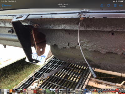

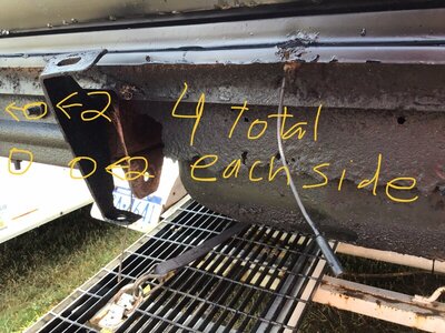

4 bolts each side, 2 from bottom one in frame one with a nut on top. Two from front to back, 3/4” socket. Unplug wires first so you don’t yank and break them.

here is a photo. You can only see half of the bracket. See the bolt pointing to the ground, there is two of these, one threads into the frame rail, outboard has a nut on the top you need to hold with a wrench. See the threads of the bolt coming through the bracket? There is two of these.
Are you referencing the bolts I have circled in red ? If so my impact will make quick work of it ..if Kroil doesn't help

Caution, the inboard ones the go into the frame you can break off with an air gun. The outboard with a nut is fair game. You can’t get your air gun on the top ones.
