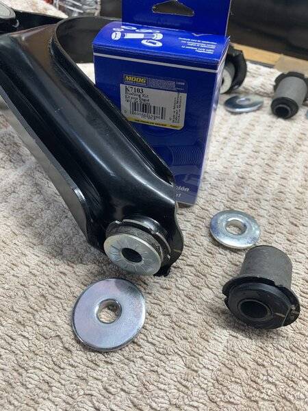

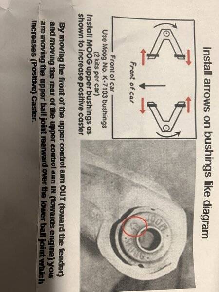

I am installing a set of repopped upper control arms on my 70 Belvedere. I am swapping out the bushings they came with for Moog Problem Solver offset bushings to get more camber. Question: The stock bushings have inner and outer “washers” that have a nice array of raised lines, I in assume to help them bite into the chassis and stay in alignment. The Moog bushing come with smooth “washers”. And, I cannot get them to seat in the bushing without some metal removal. Thoughts on the “washers”? Should I get them to snap in and go with them?
