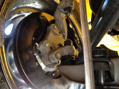

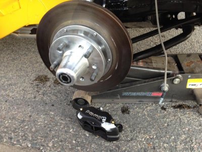

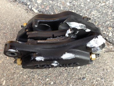

So, I'm cruising down the street nice n slow, I slightly touched the brakes to to stop at a stop sign, suddenly..... BAM, THUNK THUNK THUNK!!! I managed to get the Beeper pulled over to the side of the road. I get out to look at the damage. The front right Wilwood caliper mounting bracket snapped and the caliper bounced around and wedged itself in the wheel. I pulled the wheel and the caliper just dropped to the ground. The damage could have been worse but it still friggin sucks. It looks as though the caliper bracket actually failed. I never heard any noise prior to this to indicate a problem coming. It just SNAPPED!!!
Has as anyone else had this problem or heard of this happening? I will be on the horn with Wilwood as soon as they open is morning.
it almost looks like the disc has stress cracks in it, maybe that failed and took the bracket out, i would look at the other side as well

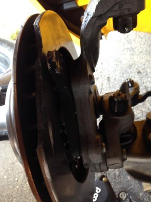

Good call. I really haven't had a chance to look at it close yet. I took these pics last night along the side of the road. I capped he brake line and limped it back to the shop. My plan was to inspect all of the brakes.

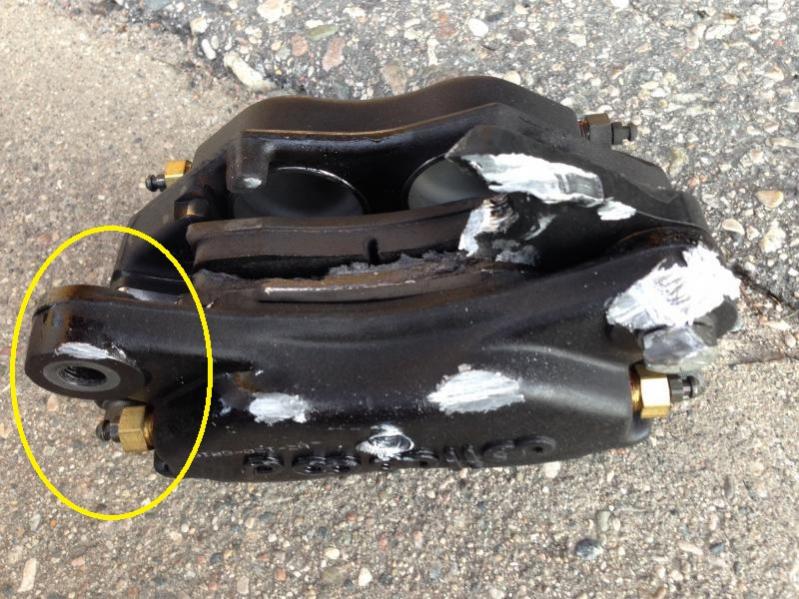

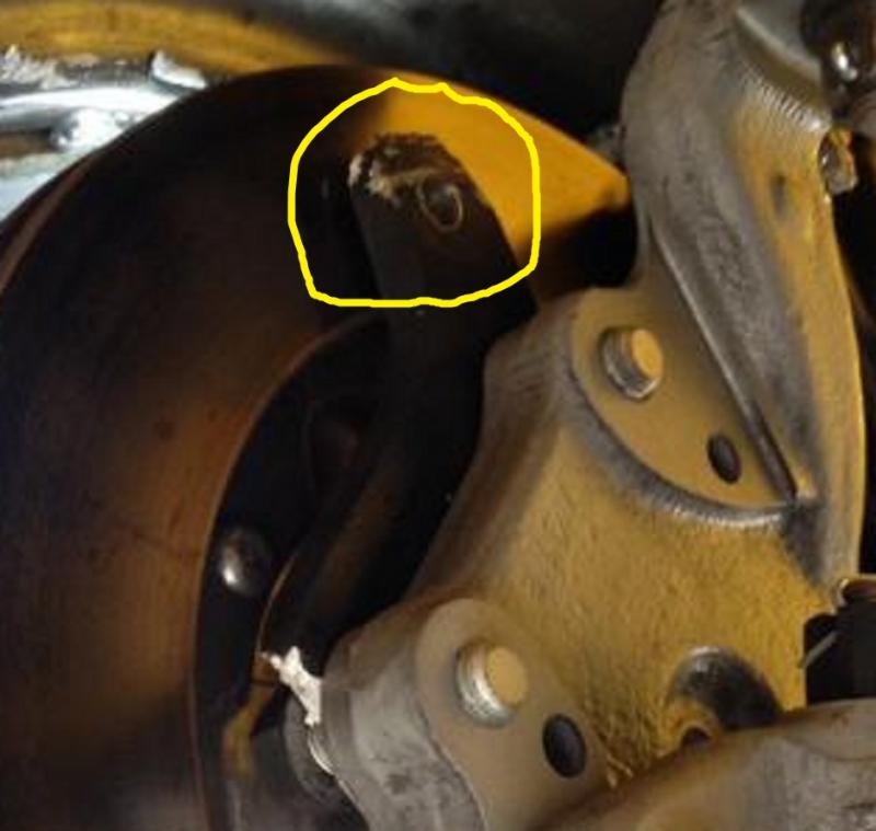

It looks like the top caliper mounting bolt was gone before this broke? maybe the caliper swung out of position and wedged the caliper in the rim which broke the lower part of the bracket off?
looks like your rotor failed. is there a chunk out of the inside of the rotor?
I think this is a good question. Did your rotor fail and take out the brake, or did your brake fail and take out the rotor? I would measure the caliper thickness and look for other signs of a problematic rotor. It seems more likely to me that the rotor failed and then the broken rotor caught the caliper and ripped it out. The opposite failure scenario just doesn't seem as plausible to me....
Either way, this sucks and I am sorry to hear this happened. Good luck with the fix.
I think the rotor and bracket damage may have been caused by the caliper coming loose from the bracket because the caliper bolt appears to be missing?
Yep.... That's exactly what happened. The "very reputable Mopar restoration shop" I had my car done at did not tighten the brakes enough on the passenger side. I pulled the wheels and checked all of the brakes and they are tight but there was no loc-Tite on any of the bolts and common sense tells you there should be at least some blue loc-tite on these bolts. I spoke with Wilwood and they recommend using red loc-tite. The shop who did my car are stepping up and sending me all the parts needed to repair this. But, here in North Dakota, we've been having the nicest weather we've had all summer and my car sits like this!
