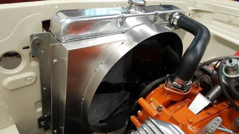

I bought an auto city classic, 26”aluminum for my 67 charger. Wait CVed from original radiator. Fit perfect, easy install and my car has never run so well. Was only $300 I think on eBay. Completely different car with that thing in.
Love it Kid!
Wondering if that setup will work on one of my 63 B-bodies...w/ a 318?
If the factory 22" fits the ECP will work. For some reason the lower passenger side bolt hole location was off but it was an easy fix. Other than that I'm sold on the two, one inch tube radiator.

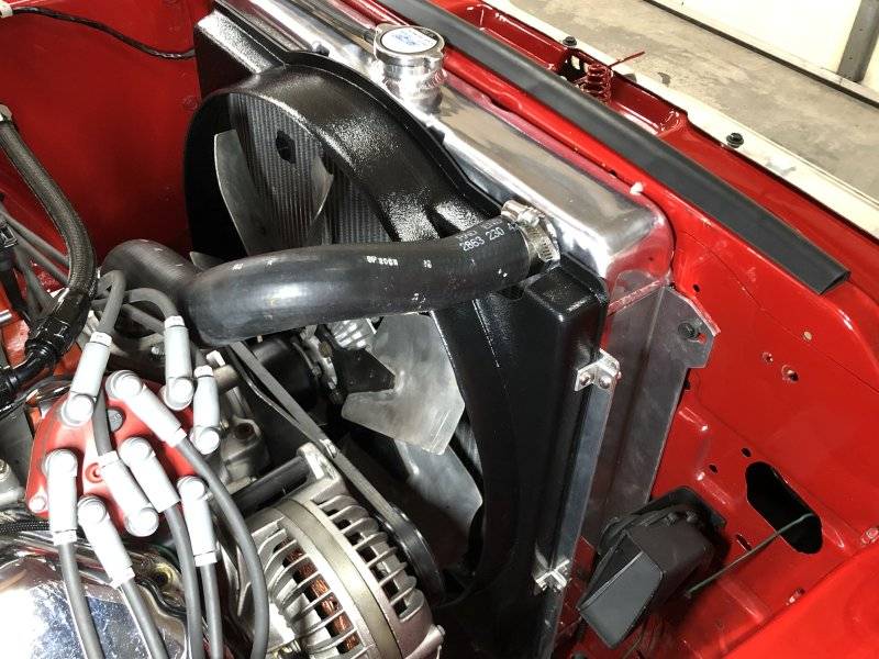

Wizard Cooling. Fit perfectly in stock mounting. Stock shroud fit perfectly. Since it was slightly thicker, I used a short Hayden clutch. Zero fabrication. Cools as it should.
