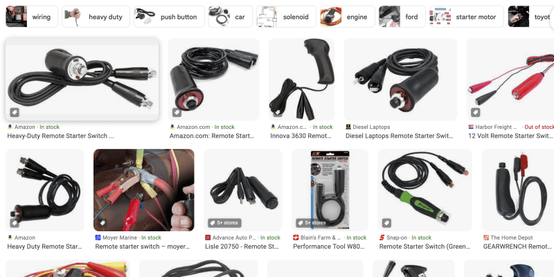

you can attach one of these to the starter

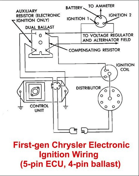

Can also cross the terminals at the relay with a screwdriver but having a hand held remote starter switch with the clip on alligator clips is better. Then run a hot wire from the battery to the coil.....IF it's a point system.
12 volts to the input side of the ballast resistor. The resistor reduces the power to the points or the ECU (if it's a electronic ignition) Neither Chrysler systems run on straight battery voltage without burning something out.
Feed the ballast with a jumper wire from batt up to the single blue wire on ballast, and as mentioned, jump out the big stud with sol terminal at starter relay to crank up the starter motor and you are done.
if ign system is healthy, the ballast bypass at brown wire side in ballast won’t be necessary for crank up and start the engine and still with a reduced voltage throught the ballast should be enough to start up the engine, just maybe a bit more starter motor turns.
