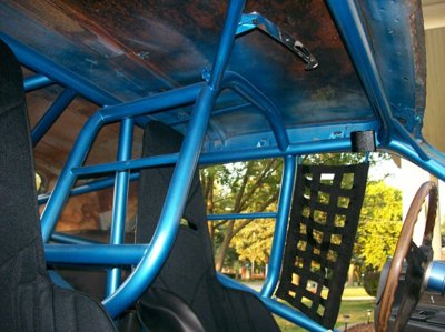

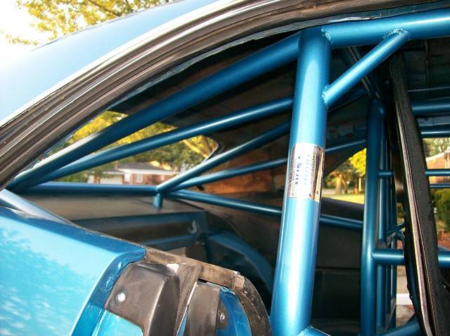

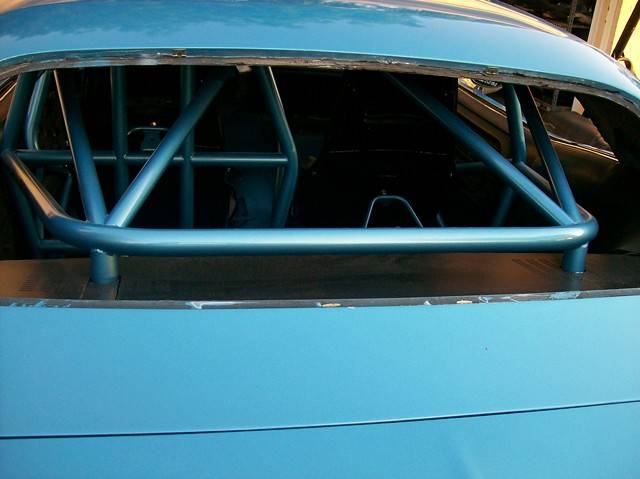

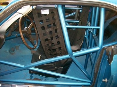

Hi thinking of putting a cage back into my 62 dart can I get some pics from anyone who has done it with a bench seat was thinking of putting A-100 seats in it and deleating the back ,any thoughts
get thought with the seats it would be different. myself going to mock it up out of pcv pipe and then do the real thing.

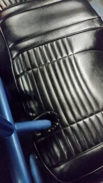

Just mock it all up & take your time. I am sure it can be done. I even left in my back seat in my car & have a couple of the bars punch through the seat that go thru the floor to the under car bars.
