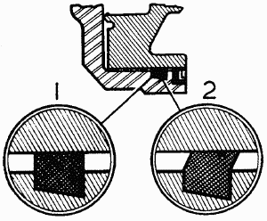

Describe not releasing. Nothing pushes back a caliper piston other than slight wobble of a disk.
There is a small amount of return from the piston seal.
As the piston moves outwards from its static position (1) the fluid seal is deflected (2). When the hydraulic pressure is released the fluid seal regains its static position, moving the piston back and providing clearance at the friction pads.
