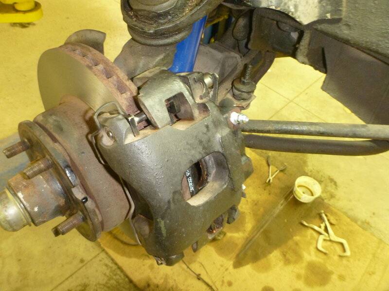

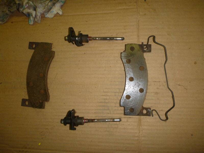

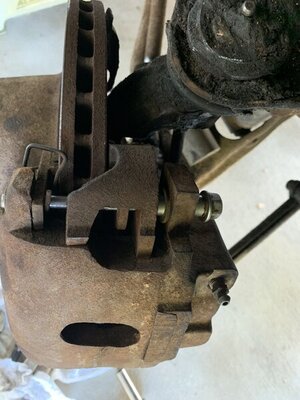

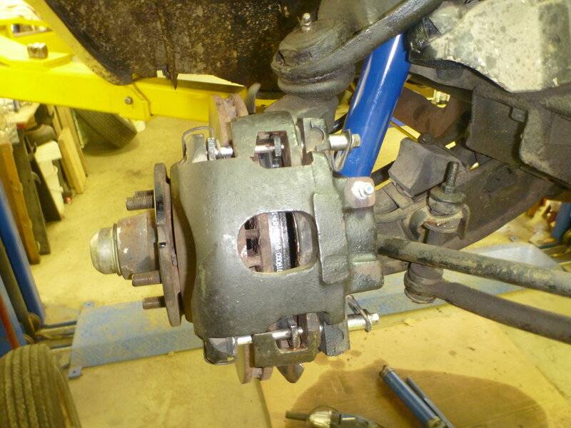

Does this retainer clip go around the bolt. Seems right just making sure
You're missing the other spacer clip under the bolt head though.. that bends down as the pads wear.

Apparently not a huge issue if they are missing, but certainly wouldn't hurt to have it complete and correct.
Later pin type calipers were not designed for the positioners. The pins were shorter on the big diameter. I think it was 1973 when they changed.
