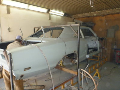

Nice well lit shop..

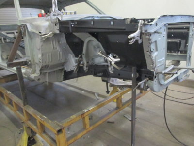

If you charge ahead, go one step at a time. Don't jump around or it will get overwhelming. The rear looks nasty so you could start there and I don't see much there that can be patched besides the window corners. What I see is outer/inner wheel houses, dutchman, window corners, trunk pan, taillight panel, trunk lock bracket, gutter channels and framerails. Weld up a frame jig to hold the rear rails in place before cutting and replacing. From the new rails weld up a jig to hold the roof c pillar and quarters in place so you can remove and replace the wheel housings (rear roof support it welded to the inner housing). And so on, one step at a time.

Parts car makes a big difference but adds twice the work because you will be cutting spot welds on on both of them. It's good to have stock metal. Jig it up and start on the rails, work from there.
DUDE...my car was pretty much exactly like yours after I blasted it. Here is a link to my build thread. Bottom line is there are exactly 5 pieces of ORIGINAL metal left on the car I started with. I simply did not know any better having NEVER built a car or even welded anything. It is a long thread but you can narrow it down to the area concerning the body replacement pages with pics and comments. Hope you have deep pockets, even if you can do the work yourself. I would build another car but I would never start from this point again! My best to you Brother.
https://www.forbbodiesonly.com/moparforum/threads/b-body-stiffening.1121/
