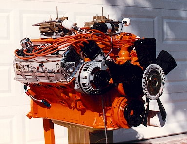

All of MoPars (DC) B & RB stage heads up to 5 are swapable between B & RB blocks. The stage 6 aluminum heads are altered that while they physically bolt to the B & RB blocks, the extended intake runners required a RB intake on a B block and spacers on a RB block.
Stage 7’s are Edelbrock castings, are completely swap-able.
I think the stageVs had to be used on a 440 block, (same deck height as a 426) the only low deck hemi intakes were very custom, and very expensive, pro stock pieces.

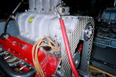

Info from big block dart forum says early eighties for prostock, comp eliminator, experiments with low deck hemis. Iron 426 blocks drying up, added bosses to low deck block for top row of hemi head bolts.
From what i read, no success in pro stock, but apparently Dave Koffel held A/ dragster record for a few years with one.
Possibly one of the first fabbed tunnel rams. If you can fab a tunnel ram, the valley cover will be no sweat.
