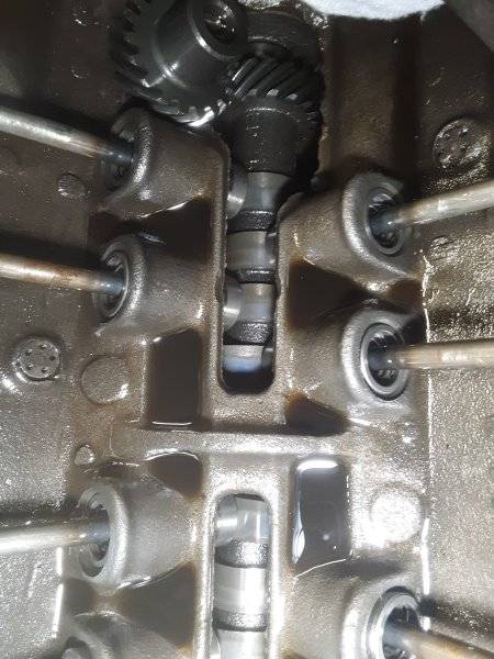

When I broke in my comp cam and lifters
( hyd flats) I used comps assembly lube that came with, plus purchased another small bottle of their lube.
I had new crane springs but left them off and used my old oem springs. Original shafts & rockers
Gibbs break in oil 10-30,
Pre lubed the engine with a drill, then poured the extra cam lube all over the cam and lifters while slowly rotating the assembly. Bolted on the intake.
Primed a known good carb , set the timing.
It fired off in 3 or 4 revs , ran it for 20 minutes around 2,500 giving it a goose up a few times. It is a XE aprox 474 lift 224 duration if I recall correct.
A few miles later did the spring swap.
I have changed intakes twice and had a good look at the cam, All seems fine.
I used rotella 15- 40 for a couple years with Lucas zinc additive. Last 2 years I've have just bought Lucas 10-40 hot rod oil with the zinc in it.
