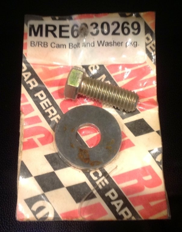

anybody have any of the special big block single bolt factory cam bolt washers? i need a good one or two.
$3 at Mancini racing....I just bought one the other day...
i seen that and they look like what hughs advertises. my question would be; are they identical to factory?
not sure...I lost mine so I had no choice.

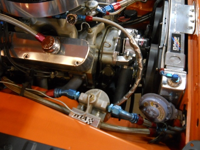

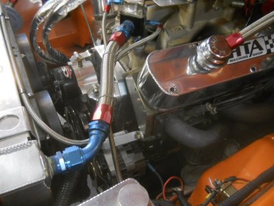

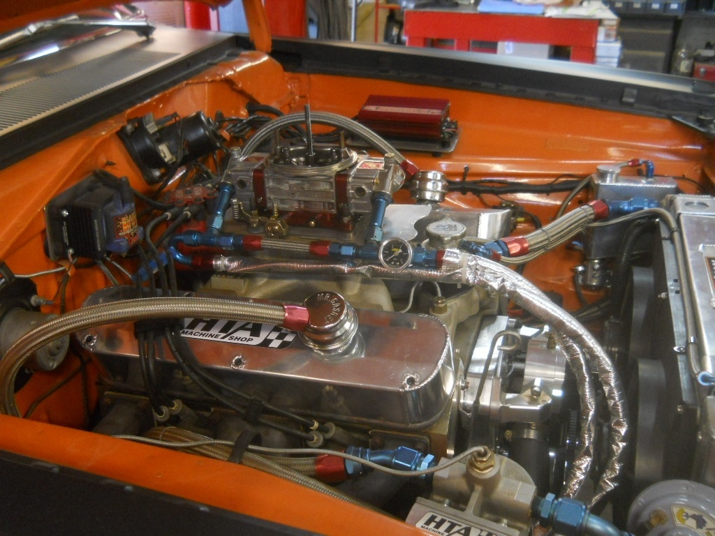

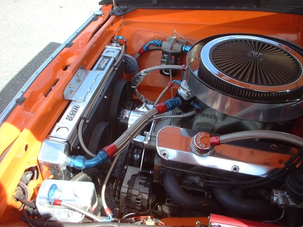

We have made the SB washer to eliminate the fuel pump drive when using an electric pump.It also allows the water pump to be moved back one inch for use of an electric fan on the rad. with electric water pump. They also have the program for the cover. The relief had to be perfect and the key cut in. We made several when the lathe was set up. I may have some here yet. I am not sure of the measurement of a BB but I am sure I can have my son make any dimension you all may need for custom gears and cam drives. Just a thought for some looking.
My son does custom HP motors for a living and fixes or makes anything. He spray welds also to fix any broken ,cracked or chipped out. Manifolds,blocks or Heads. he also straightens heads when they cannot be cut due to over head cams. HTA machine "High Tech Automotive" check him out on social media
