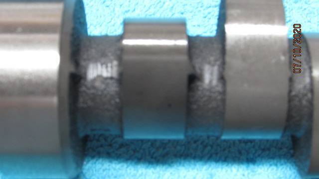

On General Mopar Tech Discussions , Title of thread is Defective New Camshaft started yesterday by Kern Dog . Read thread and got me thinking about cam change .

The sharp edge radiates off the side of the Lobe ..... which IMO is not a 'defect' ?
Maybe take a small file and de-burr the lobe edges if worried about it ?
Common part of DIY inspection of parts prior to assembly ?

That’s a new one on me....... the cam has to pass the lint snag test.
I think the problems with this cam would be a bigger issue myself......

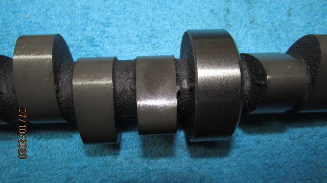

Multiple manufacturing defects on this one(not related to the casting itself):

Here’s another ugly one..... from another highly respected cam supplier that isn’t part of the Comp group:

I can't remember the last time we had a Flat Tappet Cam that passed a lint snag test ?
Just say'in...
lotsa times we've needed to take a cartridge roll and de-burr a lobe edge or two... three, whatever..... and from many suppliers ?
How many Flat Tappet Cam core suppliers are left ?
If there are bad/defective metallurgy 'cores' out there ? I don't believe any particular company has a lock on the good stuff.... they go everywhere.
