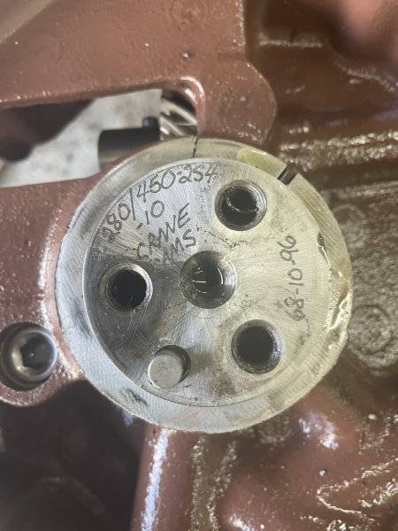

Hello,
I am interested in finding out what the specs are on this camshaft.
Thank you
That's a 10 second cam. So to speak.
Just .02 from the peanut gallery……

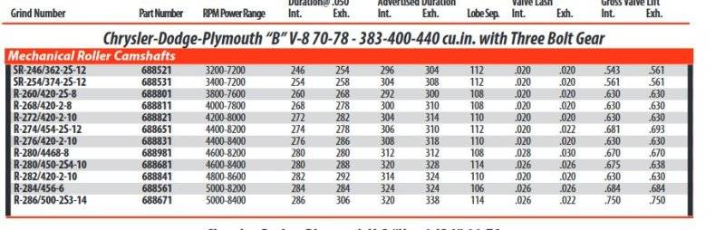

The “-10” on the cam should indicate the lsa…..110.
The specs from the link show it as 114, which I believe is a misprint.
It could easily be verified during installation & degreeing.
Edit, my 2010 catalog shows the timing events @.050 for that cam as:
I- 33/67
E- 77/31
Which works out to c/l angles of 107/113, which puts the lsa at 110.
