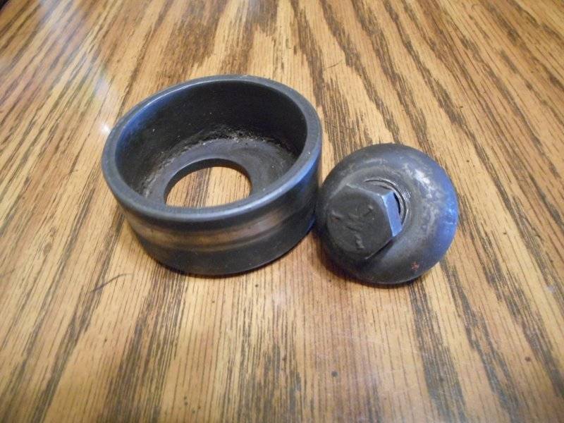

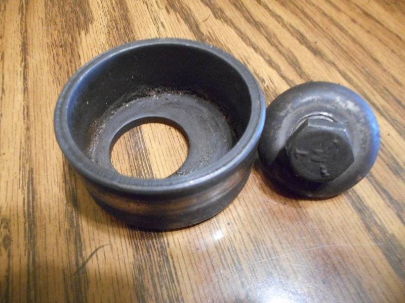

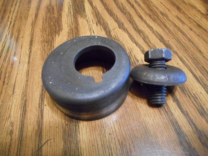

Hi, I no longer have this so I can't measure it, but maybe these pics will help you.

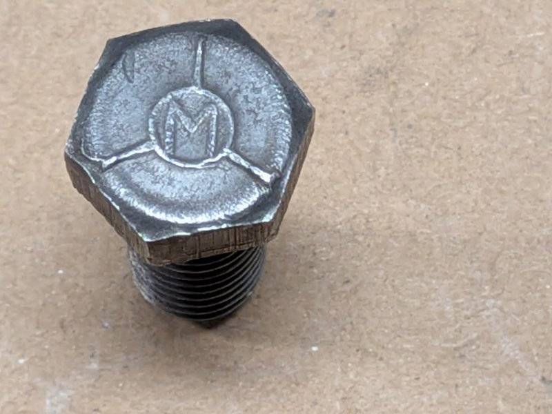

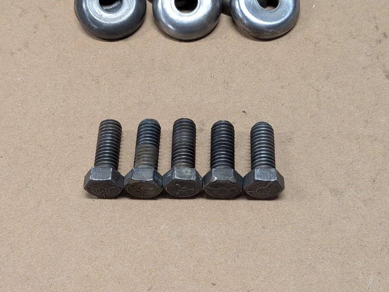

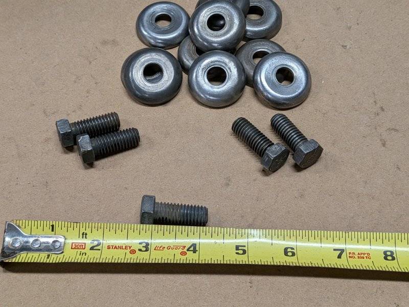

The original camshaft sprocket lock bolt for the LA small block engines (including 340) is a 7/16"-14 grade five bolt, 1-1/16" long with a 5/8" head. The sprocket fastening includes the cupped washer and fuel pump eccentric.
The following images shows an original bolt with a measuring tape:
There can be a slight variance of less than one thread width over years and manufacturing batches as seen in the following image:
The two bolts on the right are slightly shorter than the three on the left.
All of the pictured bolts were made by the same manufacturer:
I've seen some photos of four pieces: bolt, regular flat washer, special large conical washer and eccentric. I am beginning to believe the regular flat washer is an invention of some of us whereby the factory only used the special washer with the bolt. Thanks for clearing the issue up for me (that extra 1/16th of an inch is a good practice but hard to find off the shelf).
