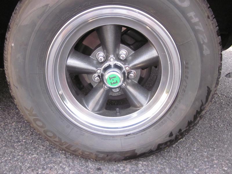

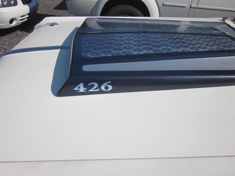

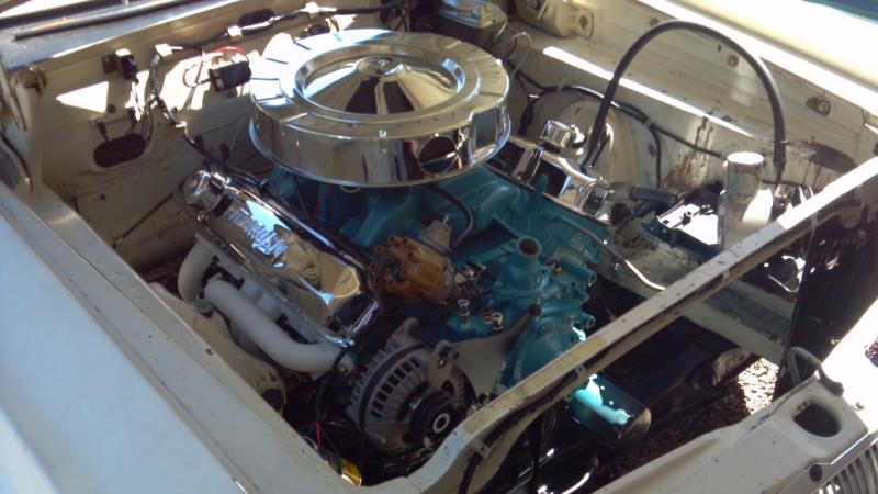

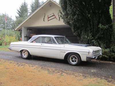

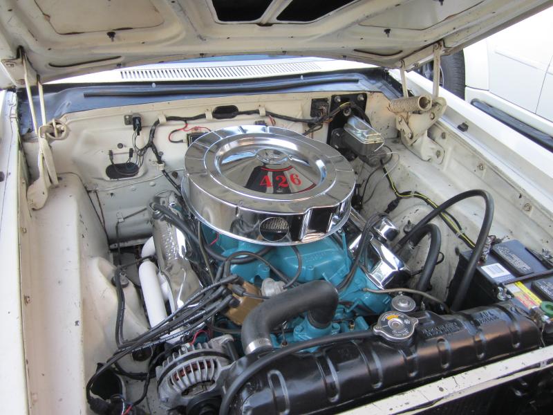

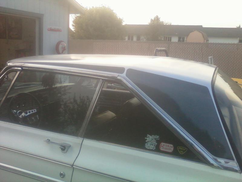

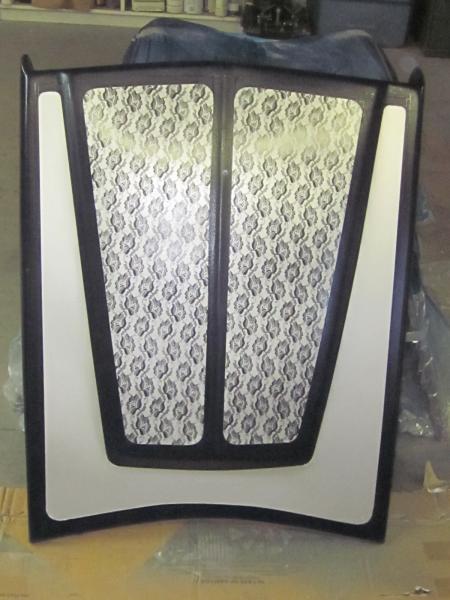

I finally found a set of front wheels that I liked. Powdercoated the cop car wheels and used a couple hubcaps I had on the rear. I painted the hood scoop and mounted it along with painting the roof dark blue to match. Also detailed the engine with a correct '64 water pump housing, Indy dual plain intake, white headers & chrome valve covers. I replaced the cam with a .488 lift 303 duration cam, new timing chain, valve springs and seals. Rebuilt the front suspension and rear leaf springs and added disc brakes and a dual master.

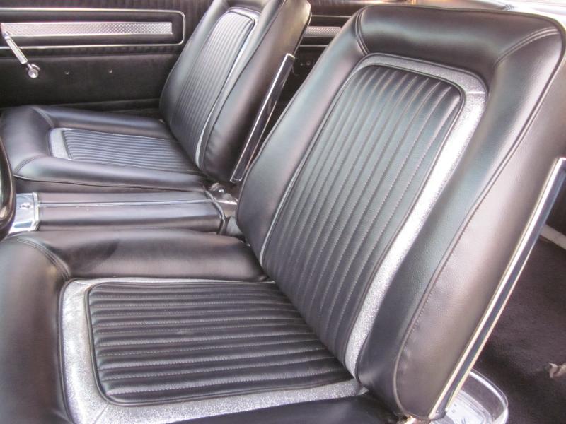

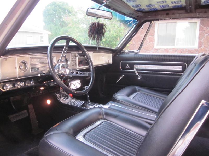

The door panels from Legendary arrived last night and the seats are back from the upholsterer. I will post pictures of the interior tonight after I get the parts installed.

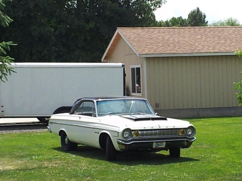

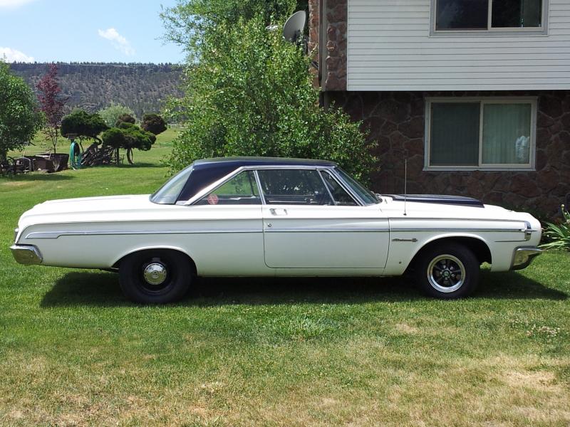

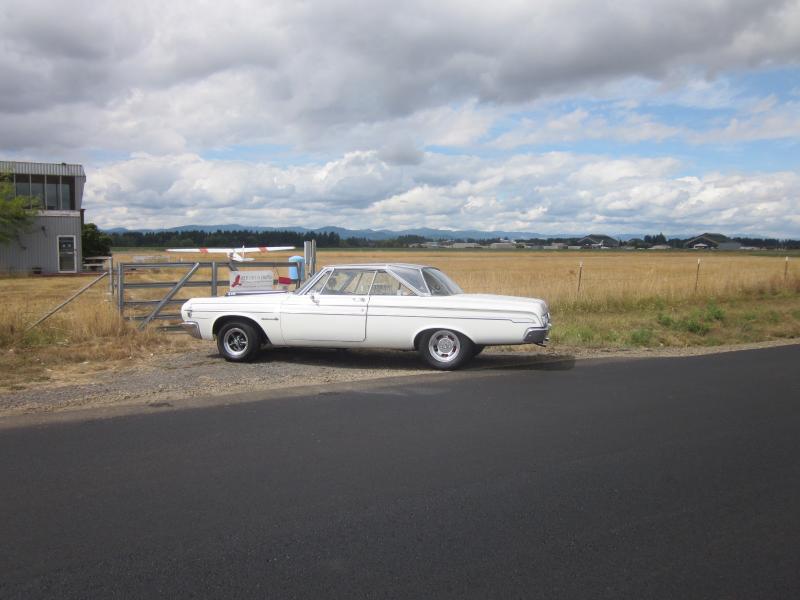

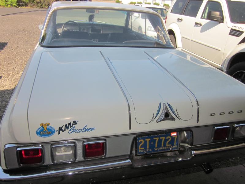

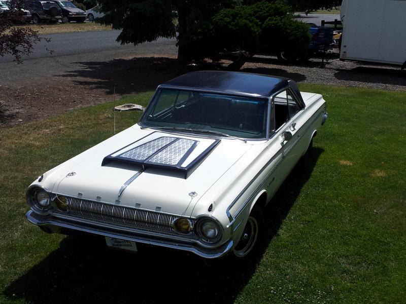

Here's one that my buddy took of my '64. This is my favorite picture of it. It's got it's fair share of scratches and battle scars and the engine compartment paint is a little rough but I figure it's earned the right to have them over the years and I am going to leave the body the way it is for now.
