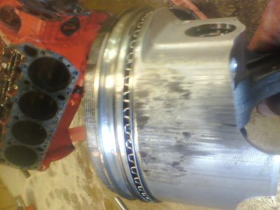

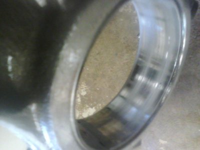

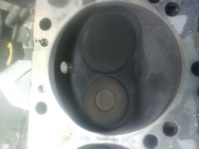

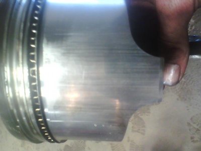

ok guys up date on my engine i got it all torn aparty now heres what i found but crank is ok but all bearings r toast due to the meatal from cam shaft n timming gear from bolt coming loose Image077.jpgImage076.jpgImage075.jpgImage074.jpg

took it to the machine shop and they said they could pollish crank. need 1 new piston the rest should be able to be saved, they may need to blast them, just a honing. heads will be fine
Make sure they don't blast the piston skirts. Hopefully, they know that.
Because the piston skirt rides in the bore to give the piston support. Also they are ribbed to retain oil. If the skirts are blasted, that will change their surface and possibly even the clearance. It's just something you don't do.
This hole mess, looks like you spun a cam bearing, this will cause the oil gallys not to get oil to the top end puting alot of pressure on the cam to turn it loosened the bolt , how much oil pressure did you have, I had a cam bearing turn on me, I by passed 1 galley and ran an oil line to both valve covers and it's still running today, plenty of oil pressure, but when the bearing spins alittle, it cuts off that oil galley, check them before you put the engine together
