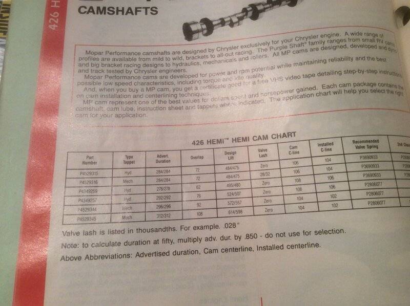

Years ago in older Mopar Performance books there was a number like .85 to get approximate duration @.050 lift. It was in the cam choice section. Think it was at the of the cam section. That .85 sounds about right. Sorry I gave away my catalogs from late 60's and 70's. Part guy once gave me dealer cost price sheet, markup was 25/30%.
No offense, but the 0.85 was total BS and way off for most of their cams. I've measured some as well as other trusted hobbiests, and some of the MP cams are 10° off from the 0.85 multiplier. Thety were not even consistant on how they measured "advertised" numbers. Direct Connection/Mopar Performance never wanted the average Joe to be able to actually compare their cams to the competition.
Found one mopar parts book. BSor not the .85 is there with the caveat don't use for cam selection.
Yep. Exactly.
MP changed vendors over the years but I doubt that the .85 method was even close even at that one point in time
you can use the adv duration for cam selection as ling as you estimate the Hyd at .008 in other words BIGGER than a same adv duration at .006 and much bigger than a Crane or Melling or Sealed Power or Summit at SAE or .004 which show much longer advertised seat durations for the same cam

As for the .85 thing.....
The 590 cam is 312 “advertised”, so .85 of that is 265.
That cam measures 270@.050
The 620 cam is 324 “advertised”, so .85 of that is 275.
That cam measures 283@.050
The .85 factor just isn’t that close if you ask me.
No reason in the world they couldn’t publish the correct info.
The “advertised” numbers are also taken at some mystery lift point.
The 312 and 324 numbers are not taken at .020.

MP 272, 0.455" hydraulic. The 0.85 number is 231° at 0.050, actual is 221°
