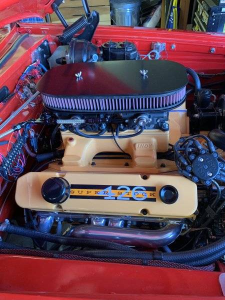

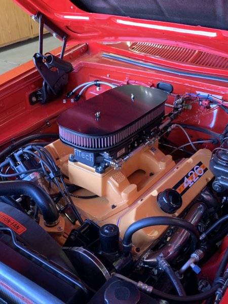

It depends on what your priorities are. My 446" has 10.47:1 compression. The cam is 235* @ .050" HFT and idle vacuum is 8". Cruising vacuum at 2500 rpm is +- 15". Four wheel discs with a booster. I get one good panic stop! The second stop, unless you give it time to build vacuum (impossible to predict), takes two men and a boy to apply enough stopping power. Choices? Remove booster and go back to manual, add a vacuum motor/can or add a hydroboost, which is my next move. Can't help you with the roller as I've not used one... I really encourage you to pick a brand of cam and then talk to the people who build it.
coloradodave, what is your lift? Is it advanced? How much timing at idle? What is your idle speed?
.540" with 1.6 rockers (.507" with 1.5 rockers)
15* Initial timing at 950rpm
108* lobe center
