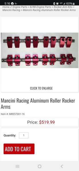

What part # are the Mancini-brand rockers that fit the TF heads? I might return the H.S. set if they are the same thing just without the needle bearings. They list a few varieties but unless I missed it they don't say which particular set will fit the TFs. Sure I can call them but since we're here...
AFAIK, the HS made Mancini rockers only come in one variety, in 1.5 or 1.6 ratio.
I myself have never test fit those on TF heads, but I have test fit them on several sets of Ede heads, which looked good to me.
The mancini are close the HS part number below. The HS rockers that end with a E are a bit shorter on their contact from what PRH mentioned above(always good to follow his advice).
We tried the mancini's 1.6 below and are satisfied with the contact pattern. No modifications to anything. I should have taken a picture. They are on TF240s with .670 lift. The lift can certainly affect the pattern.
Mancini's pictures are not always correct..ours are NOT anodized red and are 1.6.

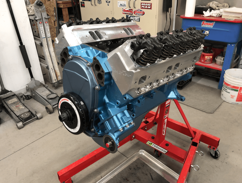

That is a beautiful looking engine. Who would have thought of B5 blue on a big block?

I admit I’m not as familiar with the earlier paint codes as I am for 70+ year models.
Still, that is beautiful and unique.
So much so that it is tempting to do this when I get around to actually painting this car B-5.
Nice work.
