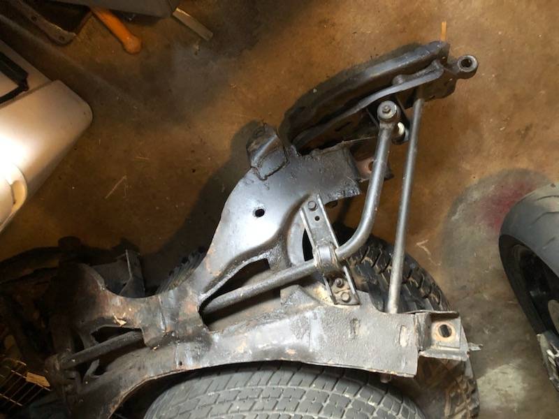

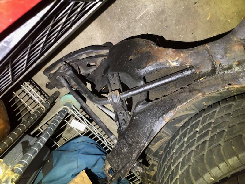

I have a 70 Cuda w/ 340 small block and was hoping this K-Member with LCA's would work. Seller isn't sure, but thinks it will. From the awkward pics and my inexperienced eye, it looks ok?
If it will work, do you see anything of concern or why I shouldn't use it?
Thank you for your help!
That could be a 1970 B body K member.
It could be a 71-72 B body version.
It might be a 70-74 E body unit.
It will work, the only issue is that the 1970 B unit has a slightly different angle where the steering box mounts. Regardless, it still fits and works.

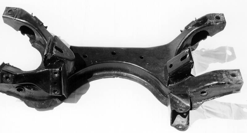

All 62-72 B, all E body K members have that curve in front:

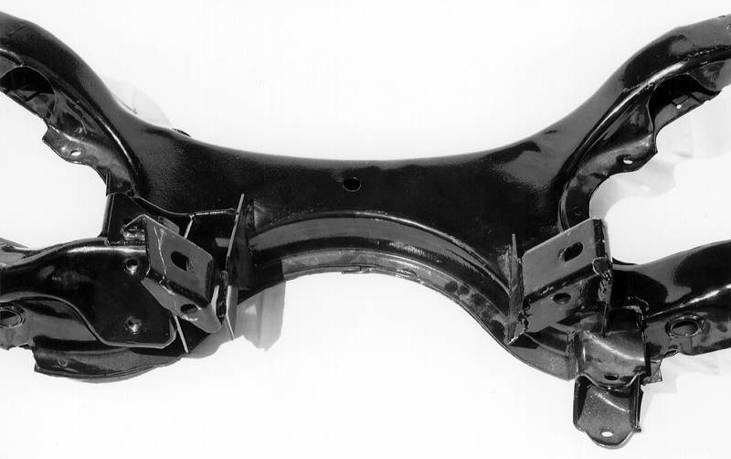

The 67-67 A body is straight across the front:

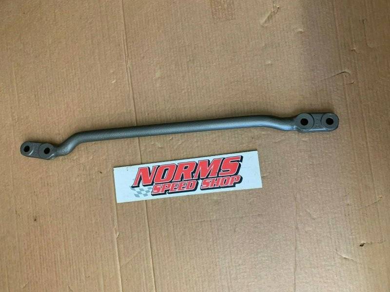

The 71-72 B body and 70-74 E body use the asymmetrical centre link because of the change in the steering box angle. If you use the appropriate centre link matched with the K frame, you can use it in a 66-70 B body. Best option is to use the correct type K frame in the body it was designed for. If you get a chance to place a 70 B body K frame next to a 70 E body K frame, you will see the difference in the steering box mount and gussets.

What about the LCA's, are they the same as my 70 Ebody?
70-72 B body and 70-74 E use the same lower control arms as far as I've been able to tell.

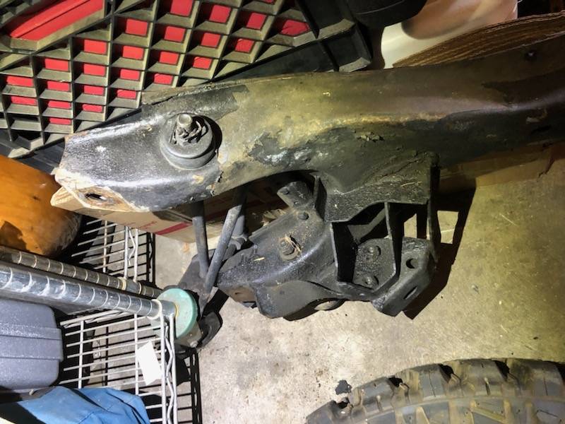

Why can’t he give you the date code numbers stamped on the front of K Member
Might even have a part number as I don’t see a stamped coin
I'll ask, honestly didn't know there were date codes stamped there. Is the stamp on the bottom or the top of the front end of K-member?
Very front like your third picture
Might have to sand the paint
You will have four numbers together - Then another number spaced
Like say
2370 2
Two hundred thirty seventh day of 1970 = 2nd shift
Or
1379 1
One hundred thirty seventh day of 1969 = 1st shift
Then if your really lucky a part number stamped close by in the front

Not all K Members came with coins - As a matter of fact , most did not
Last two are 71-72 B Body and 70-74 E Body - You can see the difference on the left , gear end angled
First picture is 70 B Body earlier - Anyways gear end is more straight
Nice. I'll compare those three pics to the two center links I have for proper ID.
