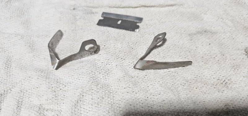

Can anyone identify these two clips and where they go? 69 GTX

The rounded end slips into the end of the lower windshield chrome. They wrap around the bottom of the A pillar and get screws into the inside of the door jamb.
