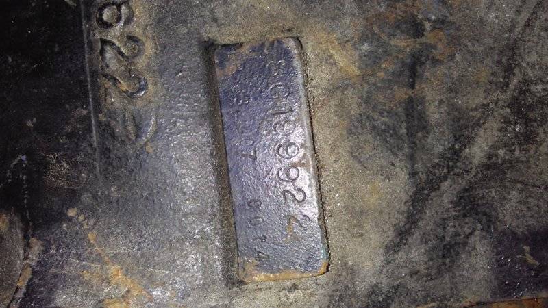

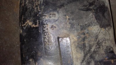

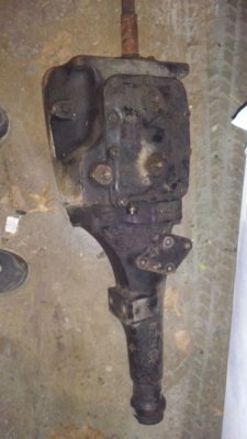

Any idea what year/make/model this transmission came out of?
1968, something built in the St. Louis, Mo plant. No way to tell what kind of car from the partial vin, but it's a B/C body transmission. The shifter mount plate kinda looks like Inland but hard to tell from the pic.

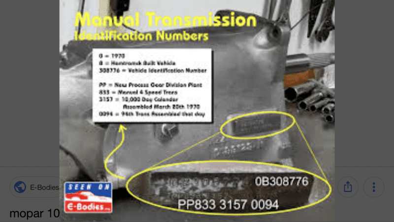

So, is that VIN ending 8G199922, new process geared A-833, assembled Feb 9th, 1967 (40th day of 1967) and it was the 14th transmission built that day?

I did run this transmission in my car with a Hurst pistol grip shifter. I had to put in a different transmission cross member, but everything else bolted right up. (my car is a 70)
