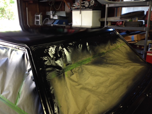

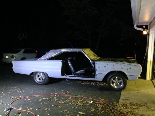

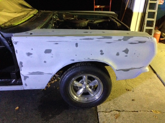

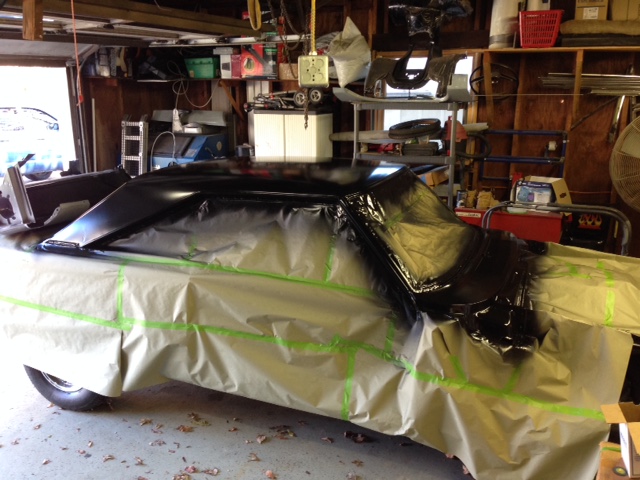

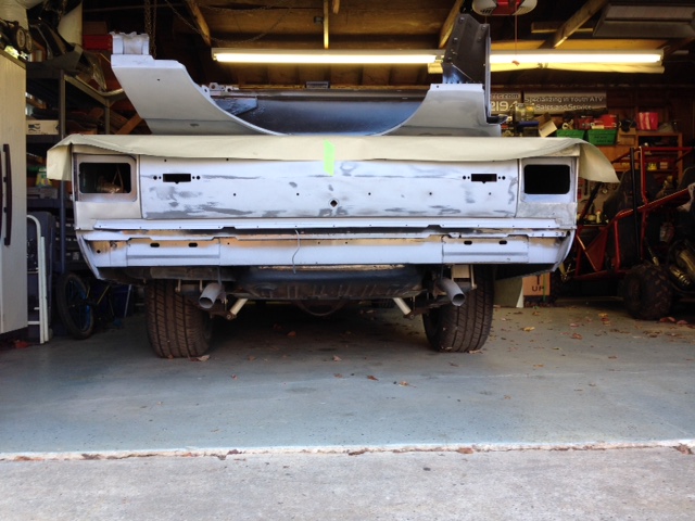

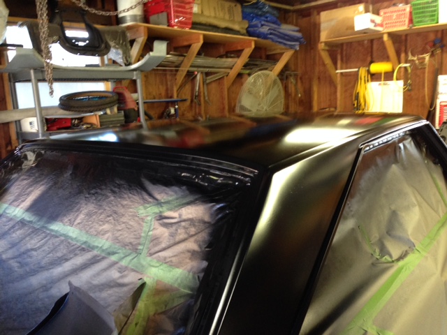

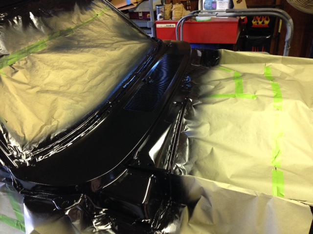

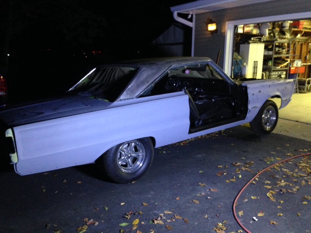

Hey guys, Can anyone recommend a Decent Body/Paint shop in NJ or Eastern PA? I've got a 66 Satellite that I have over 150 hrs of body work into. I just got of the phone will a shop in Edison NJ where the guy quoted me almost $9000 to final block and paint in BC/CC. So far the entire car was striped to bare metal, All major rust repair and fabrication was done, (If you aver tried to take on a 66-67 B body you know what I mean) and I've got 3+ coats of SPI Gray High build primer on the car. Most of the hard work was done already and I'm just not feeling spending almost 9 grand to finish it. I'm really just looking for a shop to take on minimal final blocking and paint in LL1 Turquoise BC/CC. Beside not actually having that kind of money, I thought that by doing most of the major work myself, it would make it affordable enough take on this project. Am I crazy to think $9000 is too much to spend to block and paint a car? I would almost be OK at like $3500 - $4000 but $9000 is out of range at this point and I'm starting to think I'll never get it done. See Pics below.

So this is a tough question, because it depends on so many factors. Heck, you could get a Maaco special for few hundred bucks.
For a top notch paint job, paint materials alone can run a couple of grand. Depending on what kind of final finish you want, there can be a LOT of time in addressing small details. These are the kind of details that a top notch shop would want to take care of to ensure you are happy with the results. They are also the details that separate a great looking car from an OK or even semi crappy looking car. The other day I painted my windshield headliner trim. It looked great before I painted it, and then looked like crap after I did - lots of small dents and imperfections that I didn't see earlier.
I understand the caution that a body shop may have in quoting something like this, since they have not done the prep work. Here is a suggestion: Ask them to quote a primer job and final block sanding, plus a final paint job with NO bodywork or additional detail work/prep in between. Also agree that after the block sanding you will inspect the car with them and agree on any extra cost work you want them to fix. If your work is near perfect, you still have the price of the true "paint job". If there is a lot to fix, you can work with them to fix the car to the level (and cost) you want...

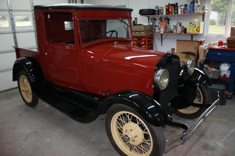

I paint all my own in a garage....the only vehicle I never painted was my wife's intrepid after she tagged someone...insurance took care of that.
With BC/CC it's pretty forgiving and you can wet sand and polish it after to get rid of any orange peel or dust.
I use eye loops on the garage ceiling, string clothes line rope through them and hang painters plastic through to the floor. A box fan at the garage door blowing out with cardboard sealing off all the side openings and I also tape at the top of the garage door so no air gets in there. Spend a lot of time cleaning the ceiling, garage door tracks and light fixtures with clean soapy water. The last time, I also sprayed the floor down, layed painters plastic down on the wet floor, covered it with cardboard and wet the cardboard down to keep dust down. It seemed to keep the dust down really well....and kept the paint from sticking to the concrete. I always open a window outside of the booth to let fresh air come in, and typically spray down the floor outside to keep dust down also.
The last vehicle I sprayed, I used Sherwin Williams Automotive paint. They were running a special with 3 quarts base with thinner, 1 gallon clear and activator for $300. I'm old school and use a siphon feed gun....never got the hang of an HVLP. This is what I last painted and it turned out pretty well with minimal wet sand and buff work. We had just north of $600 in both colors on this one...not including all the primer. Wheels were powder coated.
Oh yea....get a good charcoal filtered face mask, and I also wear a paint suit and head sock.....otherwise you will feel like flypaper when you spray the clear.
