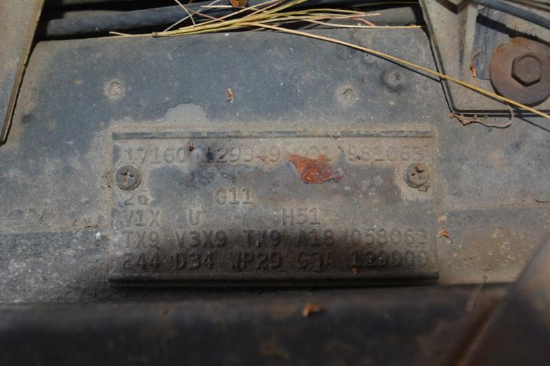

Can someone decifer this VIN?
satellite66
10:26 AM
Dec 16, 2009
249
28
Jamestown, RI
This is a photo from a 73 Charger for sale on Craigs for 2500. Looks like it needs some work and the seller doesn't list too much info. The speedo in the car goes up to 150 so I figure it has a big block but don't know. chargervin.jpg

26 = 26" Radiator
V1X = Vinyl top Black
TX9 = Black
U = US Spec
G11 = Tinted glass (I think)
H51 = AC (again I think)
D34 = Automatic
E44 is the carb code but I don't know those by heart
V3X9 is the interior code
A18 would have been an option package
WP20:
Dodge Coronet,Charger
Premium
Unknown
G3A: 318 150HP(net) or 170HP(net) 1-2BBL 8 CYL
1973
Lynch Road, MI, USA
129900: Sequence number
244: Unknown
D34: Light Duty Automatic Transmission
TX9: Black Diamond Exterior Color
V3X9: Trim - Unknown, Cloth/Vinyl Bench Seat, Black
TX9: Black Diamond Int. Door Frames
A18: Build Date: October 18
058063: Order number
V1X: Full Vinyl Top, Black
U: USA Specifications
H51: Air Conditioning with Heater
26: 26in Radiator
G11: Tinted Glass (all)
Vin decode
W = Dodge Coronet / Charger
P = Premium
29 = 2 Door Sports Hardtop
6 = Unknown - we know it's a 318 auto car from the fender tag
3 = 1973
A = Lynch Road, MI, USA
129000 = 28999th Vehicle

WP20: WP29 Charger SE
Premium
Unknown
1973
Lynch Road, MI, USA
244: Unknown E44= 318
TX9: Black Diamond Exterior Color Just "black"
V3X9: Trim - Unknown, Cloth/Vinyl Bench Seat, Black cloth and vinyl split bench seat with center arm rest; black interior
TX9: Black Diamond Int. Door Frames black inner upper door frames
A18: Build Date: October 18 scheduled production date
26: 26in Radiator
Vin decode
P = Premium
6 = Unknown - we know it's a 318 auto car from the fender tag G= VIN code for 318 engine
3 = 1973
Top row= two digit "Gate" and three digit "Base" number then a six digit assembly number. All numbers are related to producing the body in white.
The rest are three digit codes for the engine, axle and transmission assemblies.
Black vinyl top on a black car with a black interior. 318 automatic with air.
