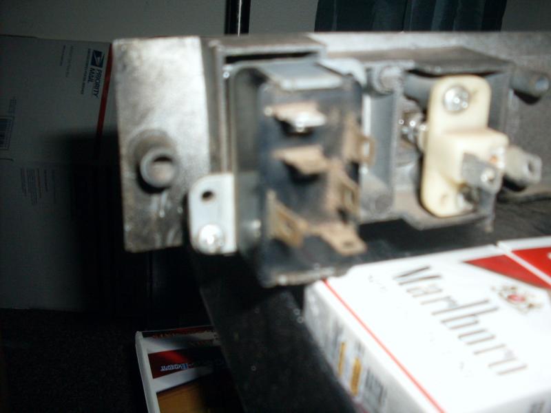

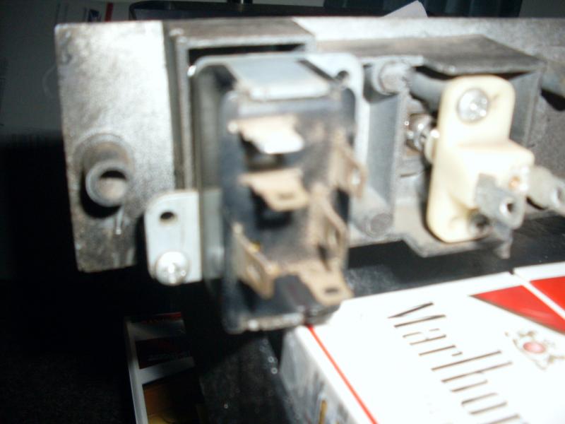

Thanks to an FBBO member I finally have the two speed wiper switch I need but need someone to take a pic of the terminal locations of a Charger or probably any B Body rocker style wiper switch. My manual shows which wires go where in a picture but fail to give terminal designations so without a switch to look at it does me no good. The terminals should be B/U,B,P2,P1,H etc. I had it hooked up and working but really need to be sure of one terminal. Thanks guys
747, here is a photo of mine 69 RR. hope it helps in some small way. the 2 horizontal on top left are "B" ,"P".The lower left vertical is (B/U", The 2 vertical on the right are "F2" and "A". The lower right horizontal is "F1". The terminal marked B/U has a tab the sticks out 90 degrees from that terminal.

Thanks, that's a huge help. Just to clarify (the two horizontal on top left B, P) I'm assuming B is the top one and P is the second one down. Same thing with the vertical ones on the right, F2 is the top one and A the second one down? I have a great manual but for some reason it doesn't show the arrangements of the different terminals only which wire goes where which doesn't do you much good if your using a different switch. That should be all I need, Thanks again
You are correct on how they are positioned. B is top left and F2 is top right. You're welcome
