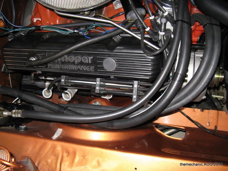

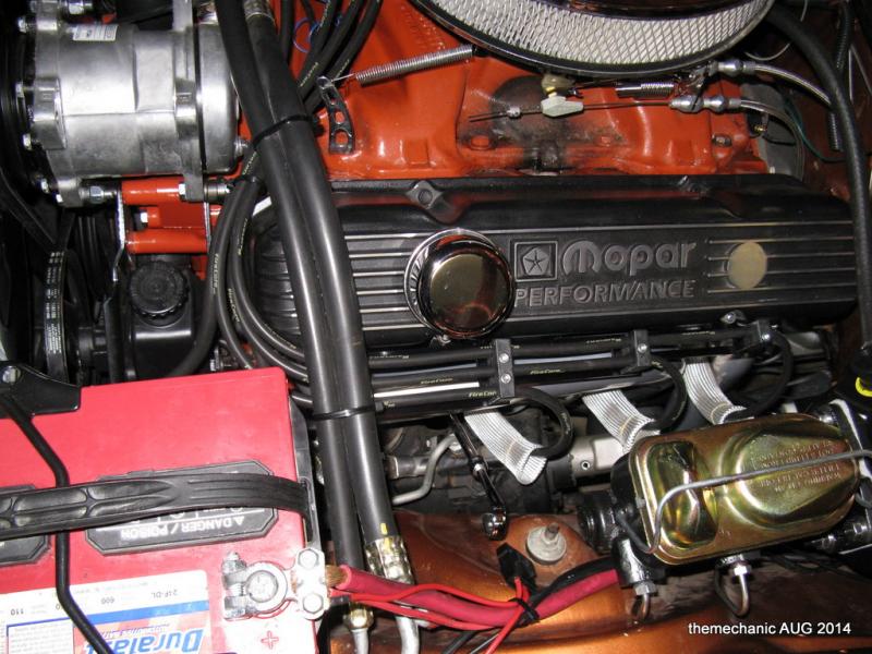

Get them at https://www.customwiresets.com/home.php?cat=3
R&M Specialies Spark Plug Wire Looms-003.jpgR&M Specialies Spark Plug Wire Looms-005.jpg
Purchase a wire set that you cut to length.
I do every time I can. It takes a whe to lay it out, cut, install the bolt and then the end, but for me, it's worth the detail and the routing I want the wires to take.
I really like my Firecore wires. Ron
Another msd buyer here. I got the same as listed above. Bendable ends. The wires work great but do not run as neatly as I would have liked. They're not bad but if you got the time, and want them very neat, cutting them to fit would be the way to go.
