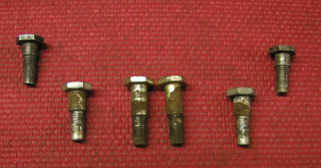

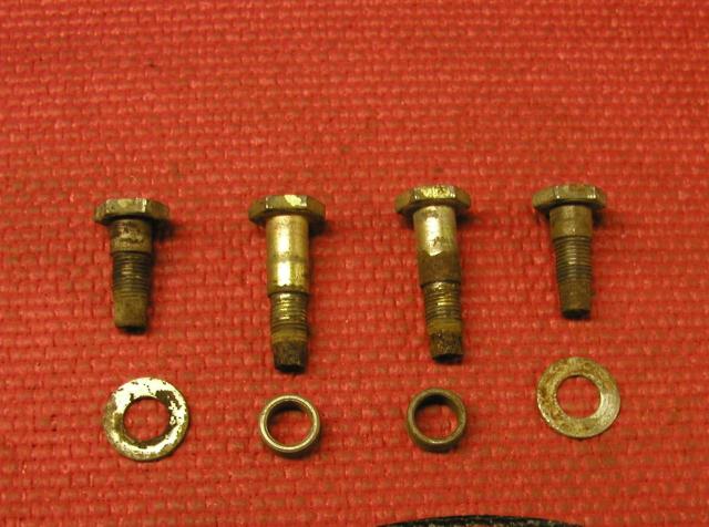

This is the best I can do. For a front bench/rear bench '69 B body (Dodge)
Rear Bench, seat belt attaching hardware
L&R side belts (outsides) 2 short shank bolts w/washers
1 1/4" long w/ 3/8" shank
Center belts (2 sets) 2 long shank bolts w/spacers
1 3/4" long w/ 7/8" shank
spacers are 5/16"
Front Bench, seat belt attaching hardware
L&R Shoulder Belts 2 short shank bolts
L&R Door Retractor Belts 2 medium shank bolts
1 1/2" long w/ 5/8" shank
L&R Center Belts 2 long shank bolts
