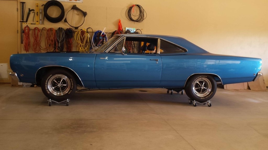

The VIN on the 1968 Road Runner I just purchased is RM21H8A208484. My question is, is it possible that could be a VIN tag off a Belvedere or Satellite? When I looked it up the 'R' stands for Belvedere/Satellite but it looks like the second letter 'M' is what makes it a Road Runner.
Is that correct?
R is the bodyline series. the 2nd letter identifies the model. The M for the Road Runner as it's own separate model existed from 1968 to 1975.
R is Plymouth,M is priceline, 21 coupe. in 1968 The priceline was L for Low(BelvedereI),M for medium(Roadrunner),H for high(BelvedereII), P for Satellite.
"R" is B body Plymouth (Belvedere/Satellite)
"M" is medium price class which is used for Roadrunner and Super Bee
Thanks guys, I guess my bird is real :)
